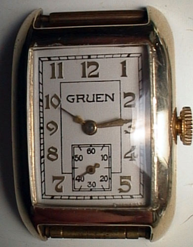

I picked up a Gruen 8 Ligne, Model 400, 17 J In a wadsworth 10K Golf filled case. The price was right (next to nothing). My question to the WW experts...
Any idea on the age of this watch, and do you folks think that this is an original dial? It looks too good for an old watch.
April 28, 2004, 13:25
David Fahrenholz
Possible, but not likely. Most painted dials unless kept in ideal conditions exhibit some weathering after a period of time. I cleaned a Gruen though last year that was very nice but the family had it stored for several years after the original owner died (the grandfather). It was a GF case as well. Very nice

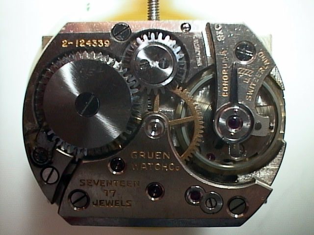

Mike can you get a shot of the movement that will help with the dating. I don't think the dial is original
Rich Kuhn
IHC Member 155
April 28, 2004, 21:18
Mike Miller
David and Rich:
Thanks for the replies. Here's a little more info on the Gruen. First the movement. There is a serial number 2-124339.

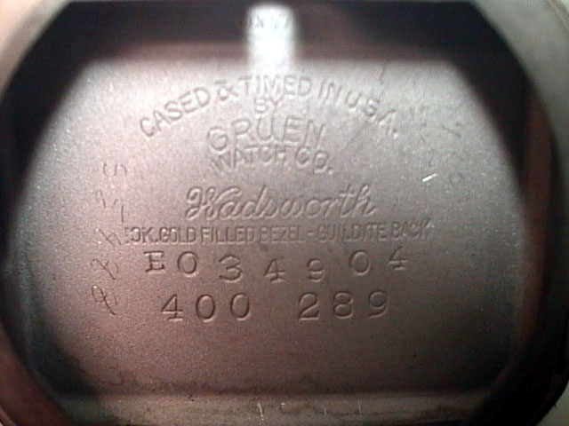

This is what's inside the case back...

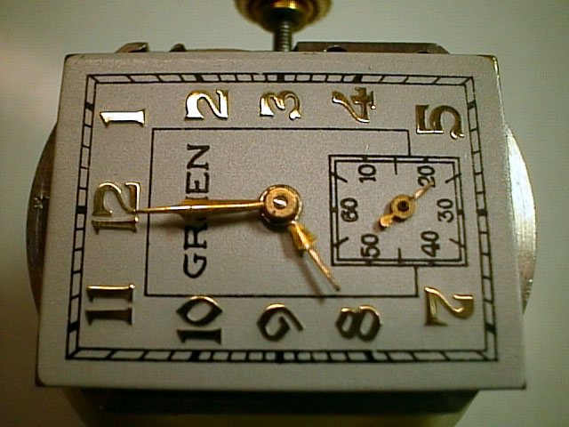

And finally, a closer look at that dial. Perhaps it was refinished?
April 29, 2004, 12:58
David Fahrenholz
Mike,
My guess is sometime in the past the dial was replaced or refinished. There appears to be no dirt marks around the dial where it meets the case. These older Gruens had poor seals and let a lot of dirt in typically on the dial near the crystal. Still a nice watch though.
David Fahrenholz
May 02, 2004, 09:59
Jeffrey P. Hess
The dial is not original.
