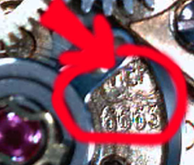

Michael Hickley
okay.Here are a few pictures of the movement.Looking closely, it looks like there are 4 nines and not 3.There also seems to be some sort of mark a bit below it.I have been offered £90.00 for the watch but i don't want to sell it to the buyer if it isn't 24k gold, especially as I don't know its true value wether gold or not.

Gerald ZimmermannMichael
Your watch is indeed a 'Rotary' ,proved by the winged wheel trade mark.
Your reading of 999 was a little mistake combined with 'wishfull thinking'. Take a jewelers loupe and turn the movement 180 degrees you can read 6663; this shows the movement marking. Your movement is a FEF 6663 movement (dating 70's or 80'---shockproof) made by the swiss manufacturer Fabrique d'Ebauches de Fleurier 1920 - 1979; part of the Holding 'Ebauches SA since 1932. Their mark is FEF in a shield.

Michael HickleyMany thanks guys and girls for the very valuable input.Especially to gerald .At last i know what it is.many thanks.
