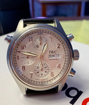

Hi Just thought I would share this, just back form a watch show and picked up a great IWC Doppel split second chronograph, beautiful watch.

movement is based on the 7750 but greatly enhanced from base and split second added.

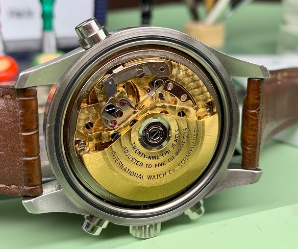

It was sold as just been serviced by his "master watchmaker in Austin" (isn't every watch sold so) was hard to check over in a quick deal at show, once I got home was late, next morning it had stopped, so took it apart.
Stopped due to simple hand clash of sub second dial to HH, the 12hr chrono would not reset to zero he must have ran it to zero and stopped chrono to make it look correct for show, once apart I seen the problem his "master watchmaker" had put the reset parts in wrong way around and would never work, also the day date wheel was out of sync so fixed it all and now running great, but buyers beware at shows, I can dig myself out of a hold thankfully :-)

Glad to have a happy ending Chris Smile
The "master watchmaker in [Texas]" title belongs to you! (Definitely NOT to the one who messed that wristwatch up).
