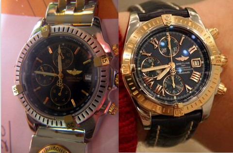

A friend brought over what he thought was a genuine Breitling wrist watch. This photo shows the comparison of the dials. The fake is on the left. A genuine is on the right.
The two look almost identical until you look very closely.

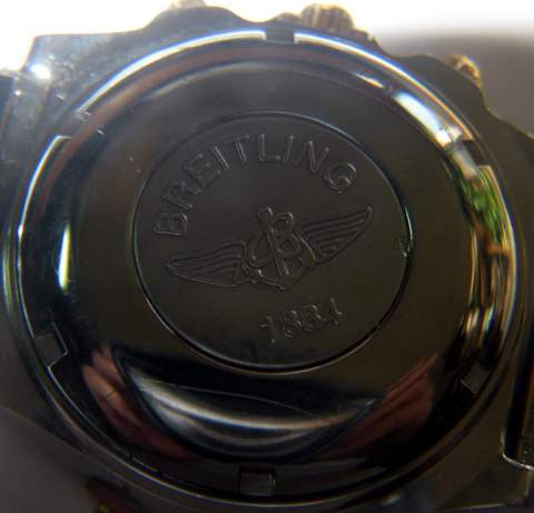

Ernie LogaHere is a photo of the back. It is very heavy and screws off.

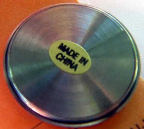

Ernie LogaWhen the back was unscrewed there was a big Made in China sticker attached to the inside.

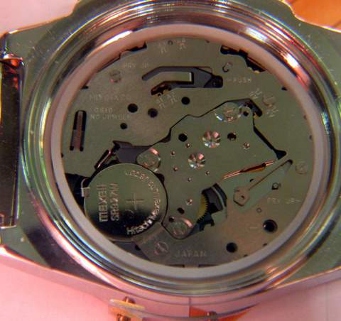

Ernie LogaThe movement has made in Japan and is battery operated. I believe the genuine is a self wind.

Ray HallenbeckHi Ernie, Which one is the Fake?...You say that the fake one is on the left and the real one is on the left....
These fakers are getting better with the hi tech machinery to fake these high end watches and it's getting harder to tell them apart.
Thanks for posting this.

Ernie LogaHi Ray:
Sorry about the confusion. I need a proofreader. I corrected it now. the genuine Breitling is on the right.
Another interesting tidbit is the bracelet says Breitling Swiss on it. but the small watch in the band has Singapore signed on it.

Bernhard SchmidtI might be wrong but I think this movement where used in the genuine Breitling Jupiter Pilot or Navitimer quartz models in early 90s or late 80s. There are similarity's anyway.
/Bernhard

Bernhard SchmidtYes, sure fakes are common, and most of them is determind quite easely. Just have a look at the bracelet end piece of the fake one, gold color all the way. Some are really hard though. Have seen really well made ones but usually when you are having a look at the movement you catch ´em but sometimes the movements (7750 look alike) takes a picky eye a while to actually determine it's a fake, so be careful folks. It happens, not very often though, that watches comes in where it seems like the owner is not aware of its origin. Very sad, I think.
