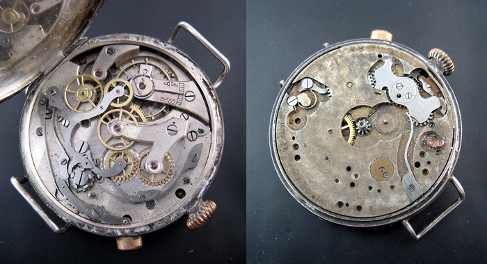

Hi!
Here is a watch that I am quite corious about. I wonder what kind of mvt it is and what its extra function was: I believe it was a stopwatch. The mvt measures 37,5 mm so it´s quite big. If you can identify the mvt what kind of watch company had these inside. The case is 0,800 silver and measures 41 mm.
Hoping for some help.

Here is the inscription on the plate.
/Bernhard

Bernhard,
From the view of the movement (the picture on the left), it does look like the extra function is indeed a stop watch/chronograph. From the picture on the right, it looks like you're missing an intermediate setting wheel there, too, but I'm not familiar with this movement. I hope someone can supply more information.
