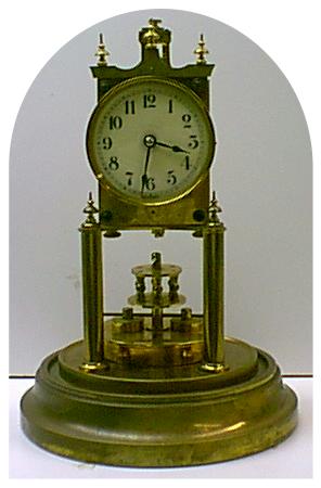

Here are some pictures of a 1908 Becker I restored for a customer.
Before

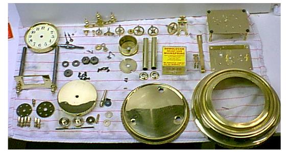

Here is one after I polished the parts all by hand.
All apart

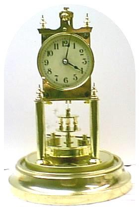

And here is the restored clock
All finished
October 22, 2004, 00:30
John D. Duvall
Beautiful work David! I bet you had a happy customer!!
