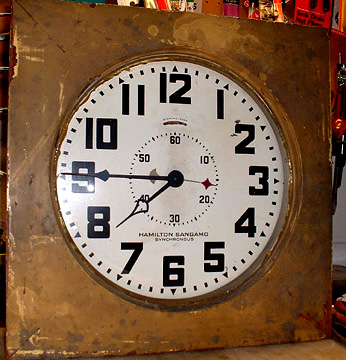

As the North Coast Regional began thinning out in early afternoon, Tom Seymour took me on an educational clock hunt. While examining a table of clocks, this beastie (hiding under the table) bit us in the legs. Finding an outlet plug we tested it. With a little coaxing the old horse ran and soon after the wallet came out.
First order of business was to service and lube the movement.This now runs smooth.
The undersize glass was heavily glued on. This will have to be replaced with the correct size. Now the fun part...removing the thick paint slopped on many years ago.

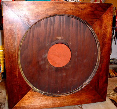

Ralph RehnerAppears that nice lumber is hiding underneath that paint. This is going to take some time.

Jim Cope....the dial appears to be in exceptional condition and the wooden bezel now appears to be a very nice close-grained mahogany...this'll be one very nice clock when 'Mr Eclectric' is done w/it!...

Tom SeymourLooking great Ralph!! Nice job uncovering the real clock underneath. That is going to be a real stunner when you get it finished.
Glad you took the "before" pictures.

Ralph RehnerPatience,Patience!
Many things to consider. One can say in many areas the paint was holding things together. Many pieces of wood were used to make the door and loose segments had to be glue backed together. The new glass has arrived and a bit of fitting is in store.
A methodical approach is the key to a pleasing outcome.

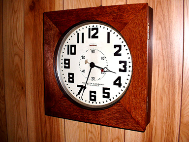

Jim Cope...factory fresh!!!another great restoration Ralph!!!
April 01, 2006, 18:24
Robert V. JonesWow!!! never would have guessed the wood was so beautiful under all that mess. Great Job!!!
