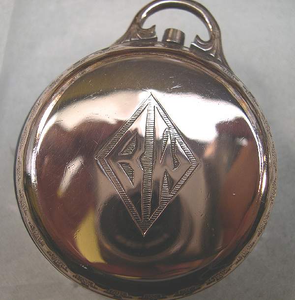

Frank KusumotoHere's the piece of trash case. Before it is plated it has to be polished to a very smooth shine. Usually with a buffer and some simichrome or rouge.
August 22, 2006, 20:40

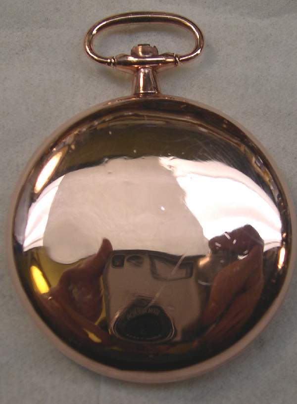

Frank KusumotoHere is the finished case. It is first plated with nickel and then with a thick coat of gold. It is a fairly durable finish and looks better than old brass!

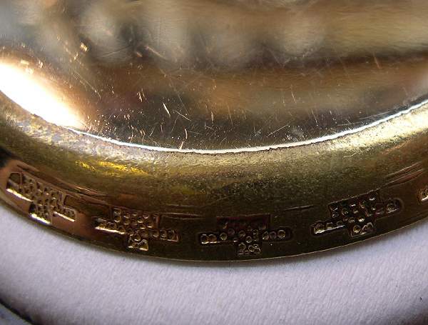

Below is a picture of the edge wear on the Hamilton Model Case. Typical ring wear. When I do some more plating I'll post a picture of the finished results.

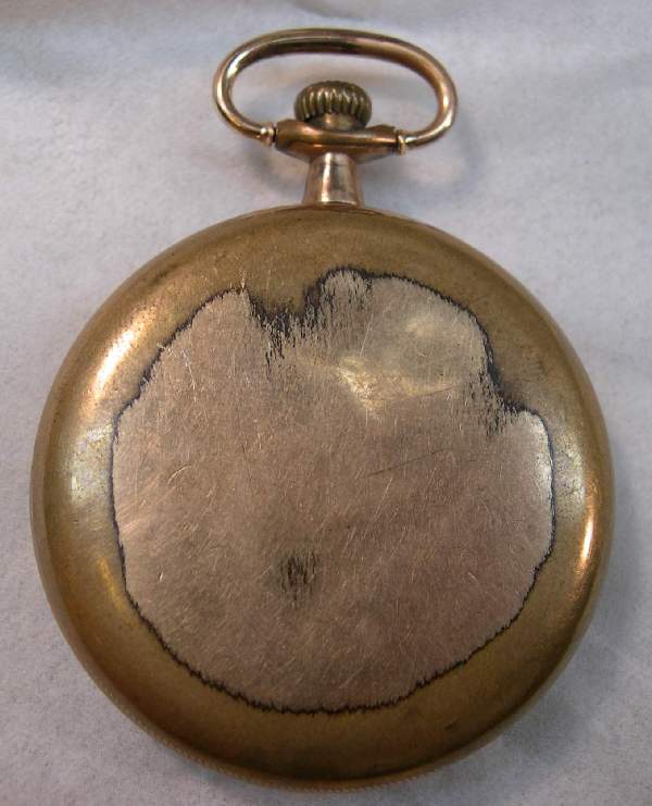

Frank KusumotoOh, I forgot I had my plating equipment all set-up!
August 24, 2006, 04:44
Frank KusumotoSo what do I have now? I don't even know what a Hamilton Railroad Model case goes for these days. I left the slight "ridge" between the gold and brass because I don't want this to be passed off someday as unbrassed. The line demarcation between the gold and brass can be polished down to a point where it is very hard to see the line and would fool a casual observer.
