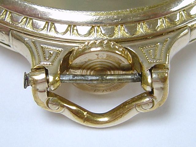

This project is a Hamilton Model #2 case with the top - bow, crown, bar over crown, and top lugs of the case in bad shape. This case is for Larry Lamphier. This first picture is the worn out top of the case.
Worn out bow and crown
January 10, 2011, 19:58
Leon Harris
another picture of the worn case
January 10, 2011, 20:00
Leon Harris

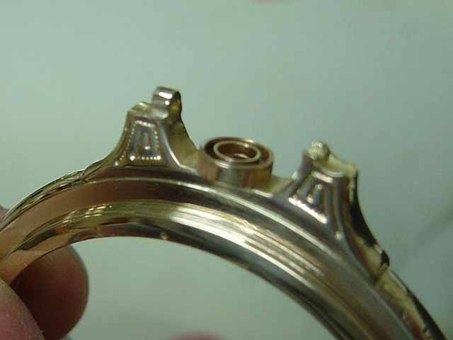

In this picture you can see the badly worn lugs on the case frame itself. These will need to be replaced.
January 10, 2011, 20:03
Leon Harris

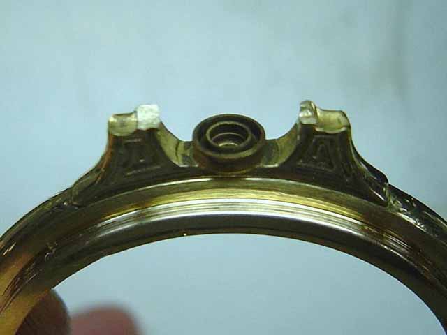

this picture i have started to remove the old lugs ready for them to be replaced.
January 10, 2011, 20:07
Leon Harris

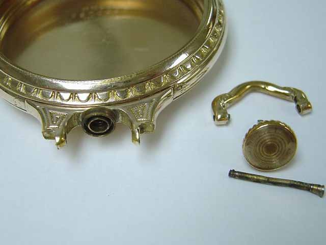

this pic I have replaced 1 of the lugs picture is a little fuzzy sorry.
January 10, 2011, 20:11
Leon Harris

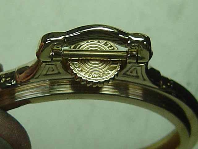

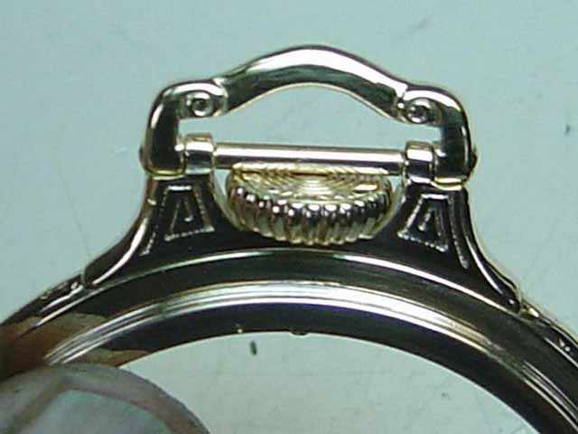

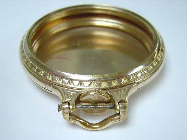

this pic is with both lugs replaced, new crown, new cast replacement bow (made from an originial bow) and a new bar of the crown.
January 10, 2011, 20:14
Leon Harris
another picture of the restoration
January 10, 2011, 20:19
Leon Harris

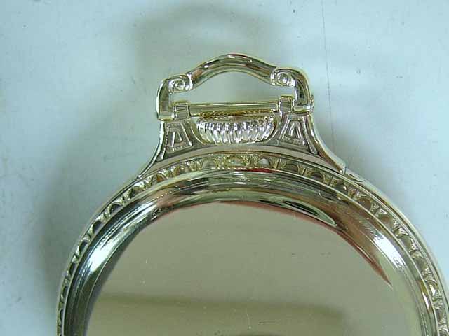

and last one polished and ready to put the movement back in.

Not bad for a do-it-yourself job! It's hard to imagine the sense of accomplishment you must get from making repairs on that level. Amazing!

I second what William said. I am truly amazed at the quality of the work. I'm sure the wait for the case I send will well be worth the wait. Can't believe how great the Hamilton case looks.

Fantastic job Leon! You literally brought this case back from "worn out" to "usable" condition.
I'm assuming you will also electroplate the worn-thru areas on the back, bezel and frame.

That's beautiful Leon. How did you do the lugs -- I assume you laser-welded them on, but did you use a section of gold tube, or did you fashion one yourself? A real nice job!
