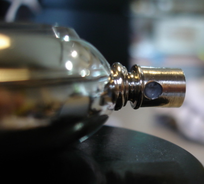

I have become enamoured of these earflap cases. The first one I bought was already shined up, then this one came along and I am working on buying a third one.

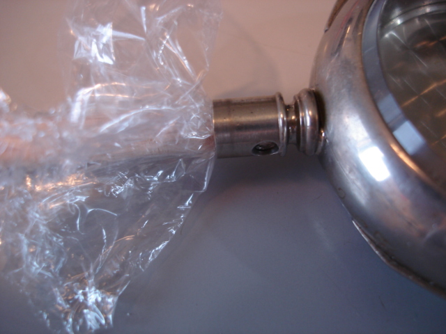

The only real issue was that the concave bow receptacles were worn through so I decided to try metal epoxy. I had to provide a dam to keep the epoxy from being pushed into the pendant where it would block the sleeve from going back in.
I just put a dowel in the drill press and sanded it down to a point where I could put some saran wrap around it and stick it in the hole without tearing it. This epoxy sticks to both wood and plastic so I figured after it was set I could just pull out the wood then pick the saran out with tweezers. Turned out the wood and saran came out together slick as I wanted.
July 15, 2013, 16:04
Lorne Wasylishen
Set up epoxy.

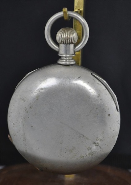

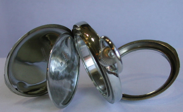

Case front before.
July 15, 2013, 16:05
Lorne Wasylishen
And after, original crystal.

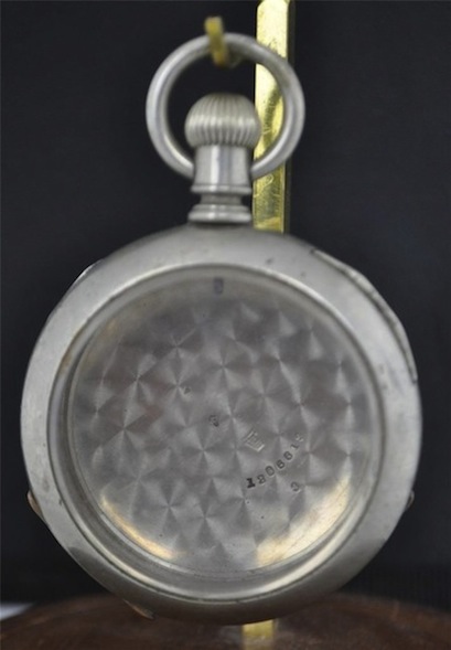

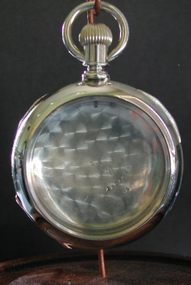

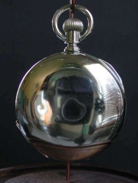

Case back before.
July 15, 2013, 16:18
Lorne Wasylishen
Case back after.

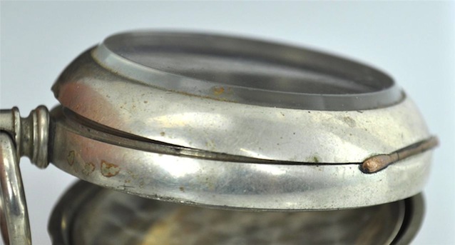

Side view before.
July 15, 2013, 16:21

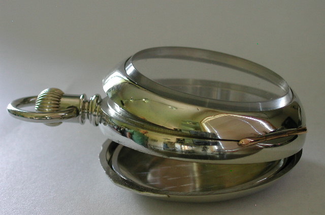

Lorne Wasylishen
Side view after.
Note the once floppy bow now holds it's position. I don't know if the epoxy will wear down but for now it seems to work fine.

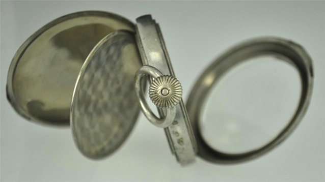

Top view before.
