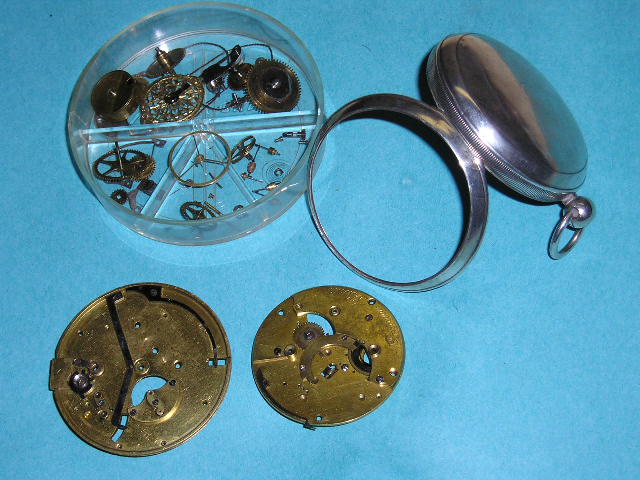

This watch came to me in pieces and was asked to make the necessary repairs. After looking over the timepiece it was discovered that the verge staff was broken off below the upper flag. The dial was in poor condition with crystal missing as well as the hands. I'm including some pictures as the restoration progressed.

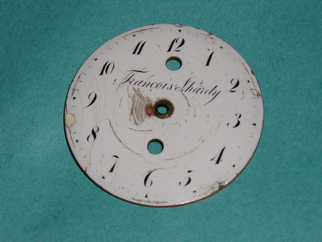

Below is a picture of the dial as it was sent for repair. Notice the signed dial by Francois Lhardy who was a maker in Paris in the late 18th century.

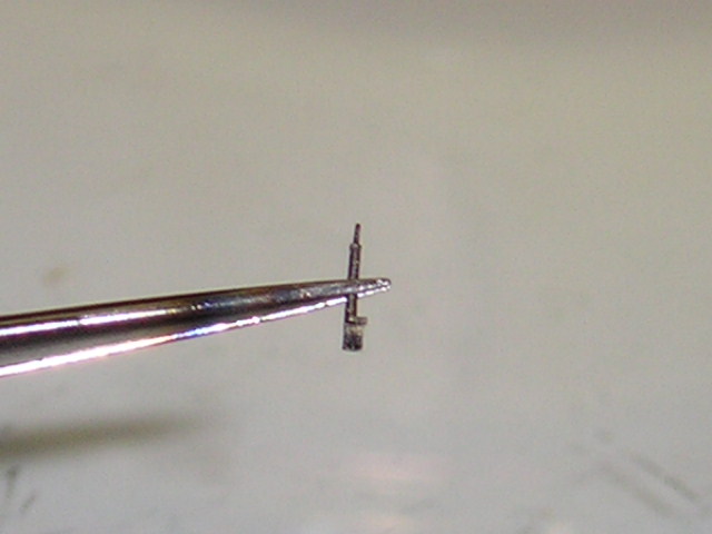

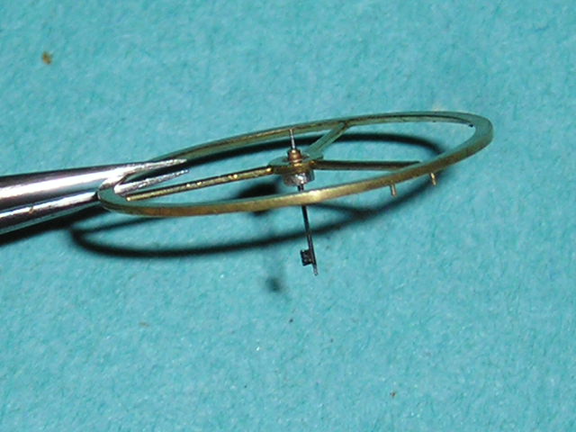

Below is the broken verge after it was removed from the balance wheel hub. After removing the hub it was heated with a soldering iron to melt the solder that holds the verge staff.

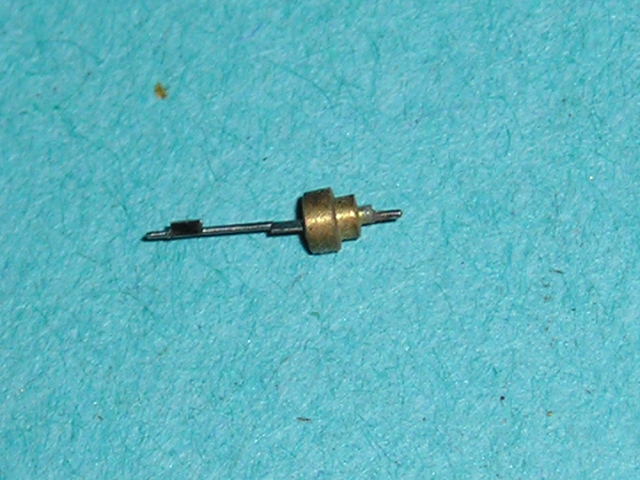

This shot is of new old stock period verge. Note the large hub... for this is a blank that needs to be removed from its hub and fit to the original hub for the balance.
February 13, 2008, 18:54
David J. Rudary
After the verge was removed from its hub it was assembled to the original hub and staked into the balance wheel.

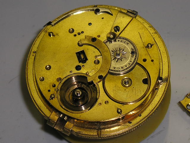

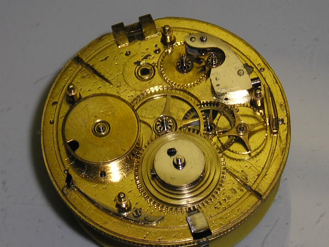

Lower main plate with parts assebled after cleaning and polishing.
February 13, 2008, 18:56
David J. Rudary
The upper plate has been placed ready to pin attach with brass tapered pins.
February 13, 2008, 18:59
David J. Rudary
Balance in place.

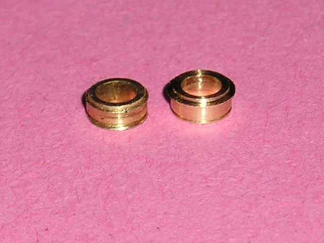

The alarm bushing was worn and out of shape to hold the hand, the step where the hand seats was ruined worn so a new bushing had to be made. The new bushing was made with the appropriate step to hold the setting hand. This step is very important for it must be adequate to hold the hand as well as having enough stock to rivett over to hold the hand securly. The setting hand on the alarms takes a lot of abuse resulting in torque pressure at the rivett. Old bushing on left.

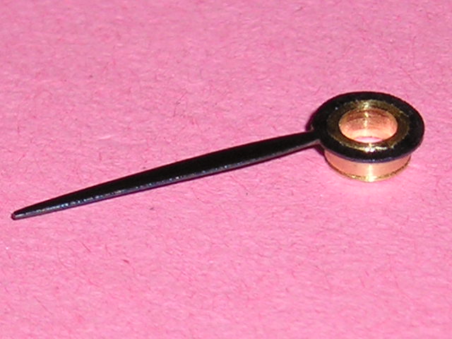

Hand attached to new bushing ready to be inserted into the dial. On the verge alarms the bushing after after the hand is set is inserted thru the face of the dial. Note groove on lower end of bushing, this groove holds a spring clip that creates the friction needed to hold the alarm setting hand in place after setting.

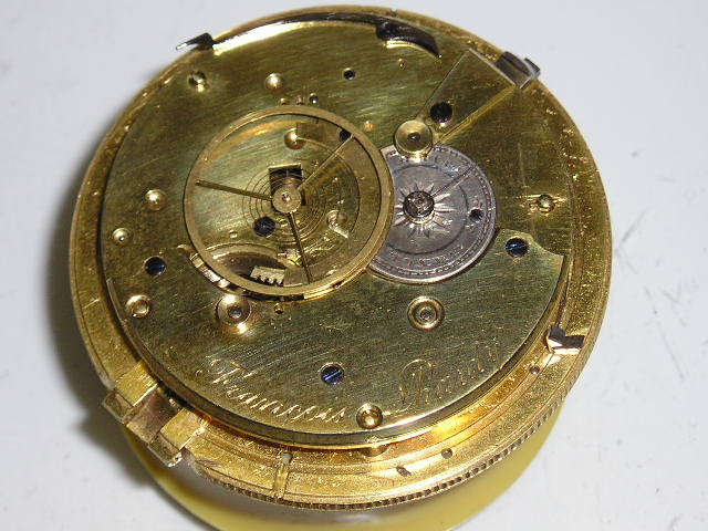

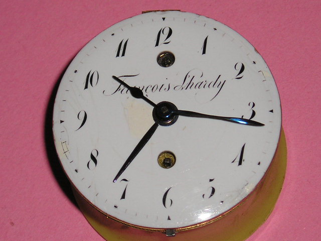

Completed Francois Lhardy after restoration work. Ready to be inserted into the case.
February 13, 2008, 19:17
David J. Rudary
Note the new hands in the finished picture, these are period style hands made from steel that had to be fit to the hour wheel as well as the square on the cannon pinion. The hand were polished and blued to match the alarm set hand. All the screw head slots were cleaned up with heads polished and re-blued.

January 28, 2009, 16:55

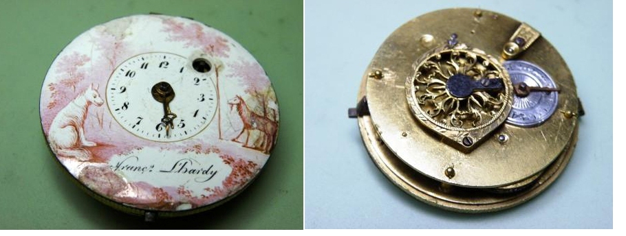

Bulent Ogel
Hi David,
On your movement the name Francois Lhardy is also on the movement.
On my movement the name Francois is not complete on the dial and don't exist on the movement.
What you think?
Thank you.
Bulent
April 06, 2009, 15:05
David J. Rudary
Hello Bulent,
Here is what might have taken place through the years with your timepiece. The movement was repalced with one of similar design, swiss/french 1850's vintage due to damage to the original and the original dial was affixed to the replacement movement? Take a look at the movement as well to detect re-drilled dial post holes, that is a sure indicator as well that the movement has been replaced. Normally there were three dial feet to secure the dial to the movement. Or the movement was not signed which is likely. If the dial appears that the feet were not moved the later could be a possibility for I have seen many many period pieces not signed.
dave
