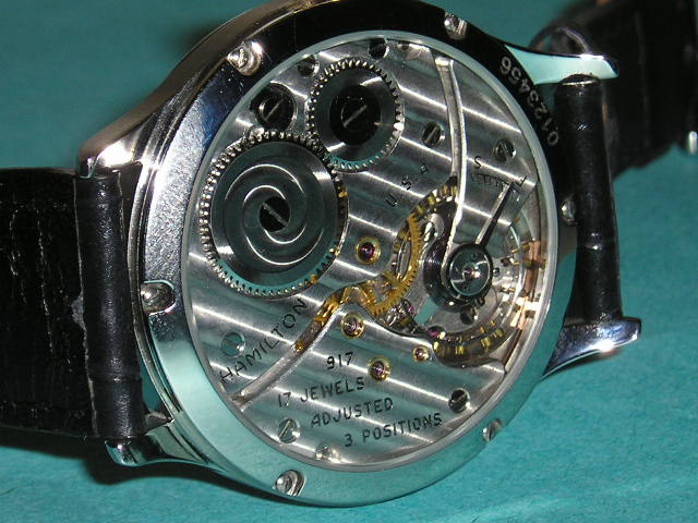

I started this project after acquiring a few 43.5MM stainless steel cases (not including crown) with view backs and an inside diameter that would accept the standard Unitas 6497 movement. This led me to sizing up one of the vintage Hamilton 917 movements that grace my collection, always thinking how nice it would be to admire one of those beauties behind glass.....especially if it was Grandpa's railroad presentation watch! Here is the result after some thought and consideration to dial and winding crown.
Thanks for viewing
Dave

Beautifully straight lined finish that Hamilton was know for.

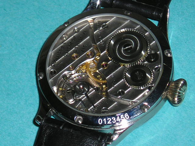

David J. Rudary
Large viewable area to enable all engraving to be seen.

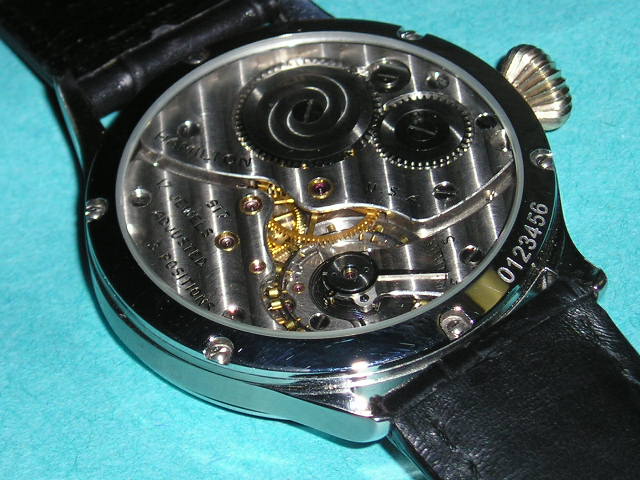

David J. Rudary
A nice conversation piece with plenty of detail. The 925 model is my next project.

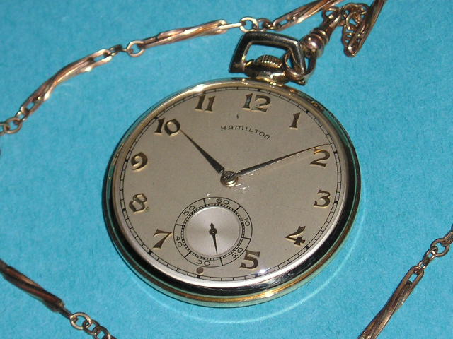

David J. Rudary
This is how it started life..
