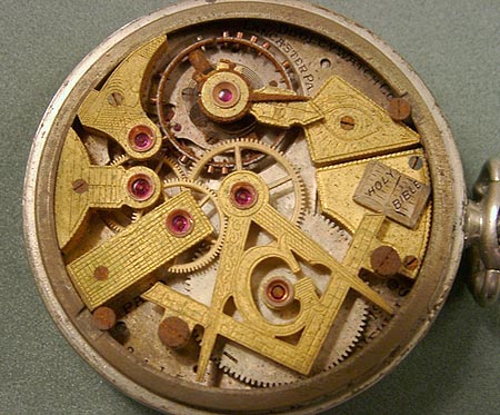

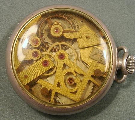

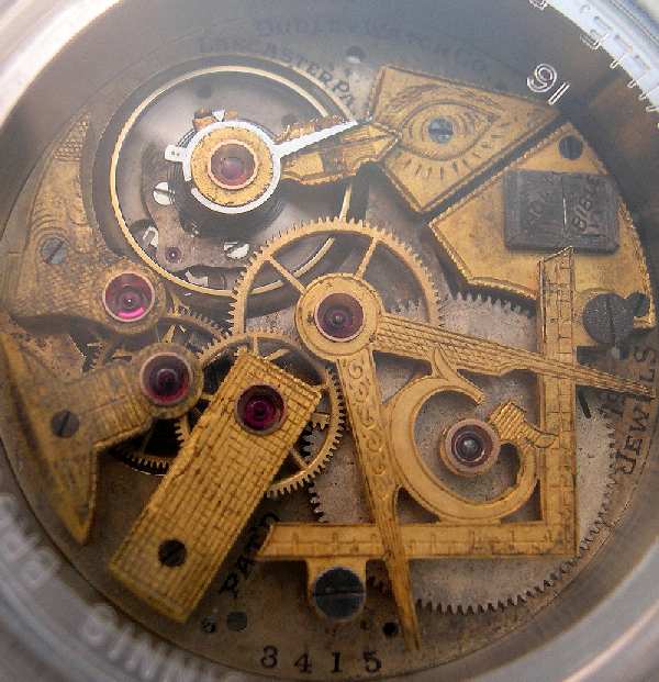

I recently got this basket case. I will put the full restoration in the Time on My Hands area as I go through the process.
First I have to find out a few things. I know Dudley Models 2 and 3 used Hamilton parts. For this project I need a complete balance and an escape wheel. Can anyone tell me what 12 size Hamilton this was based on? I am thinking a model 910. If this is the case are the balances the same and did they use the same escape wheel.
When you look at the pictures you will see why I am asking.

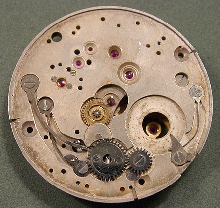

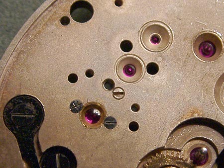

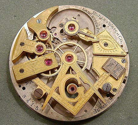

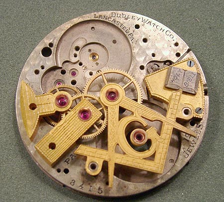

A quick update. I now have the major grudge off the movement. I have been able to save the second, third and forth wheels. I am happy about that. I soaked the entire movement in Break Free. The next step was a quick clean. Using a fiberglass pencil I worked the remaining rust of the gear train components. Cleaned the parts and did a quick assembly to make sure every thing free. So far so good!
The other area I have concentrated on is the setting and winding mechanism. That area also had a lot of rusted components. I have that working smoothly now also. In the attached pictures I show the train assembled and the dial side of the watch. I also show a picture of the missing banking pin. Does anybody know what model Hamilton this banking pin comes from? I am now thinking 912 however I don’t have any Hamilton pocket watch books that show this area. The other components I still need are a complete balance, pallet fork and escape wheel. These parts I could not save.
It appears I will be able to save all the screws with the exception of the dial screws. They are toast.
While I am looking for a donor watch for parts I will go back and polish the pivots on the gear train. Disassemble the dial plate and boil out the dial screws. (I got lucky hear again they were not screwed down tight. Thus the dial came off easily). I will also polish the plate so that it looks as good as possible.

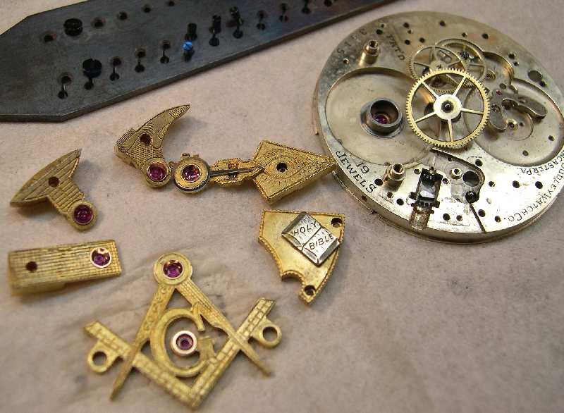

Frank Kusumoto

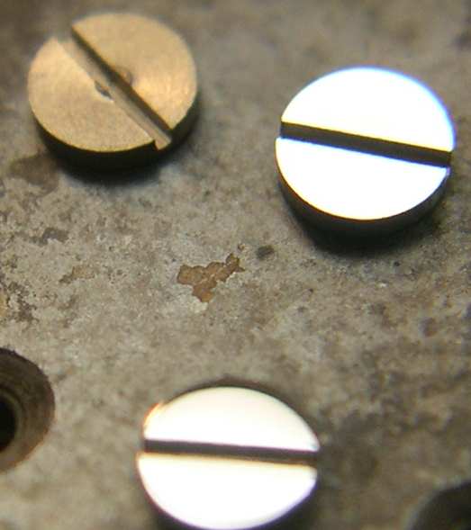

I decided to start tackling the screws first. They are not the standard Hamilton screws that the gear train is based on. After some searching I found perfect matches for the barrel bridge screws. Unfortunately they were very rough and took some time to polish. Doing the "flat finish" polish is a demanding job and I'm not completely happy with the results but they turned out good. The screw on the top left is what the replacement screw looked like and the others are the screws after polishing.
March 10, 2006, 11:08
Frank Kusumoto
Next job is blueing the screws. I put the old original screws in the picture for some contrast. The original ones are the brown rusty ones on the right. Smile
March 10, 2006, 11:12
Roy New
Frank, I bow to your expertise.
I read about these process's and WOW.
Excellent.
Look forward to the next pictures / instalment!
Roy.
"So mote it be!"
Frank Kusumoto

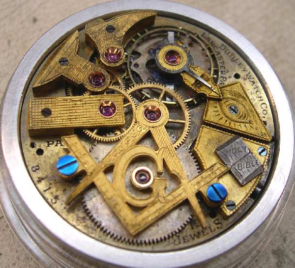

And then back goes on the barrel bridge with the nice new blued screws. Certainly does make a difference to my eyes. Now to find some matching plate screws. Roll Eyes
March 10, 2006, 21:51
Rich Kuhn
As I said when we talked on the phone I think they look great. It just keeps getting better

March 14, 2006, 23:13
Frank Kusumoto
The watch is looking a bit better today, although a little scattered. Big Grin
March 16, 2006, 15:50
Frank Kusumoto
Starting to get there .......
