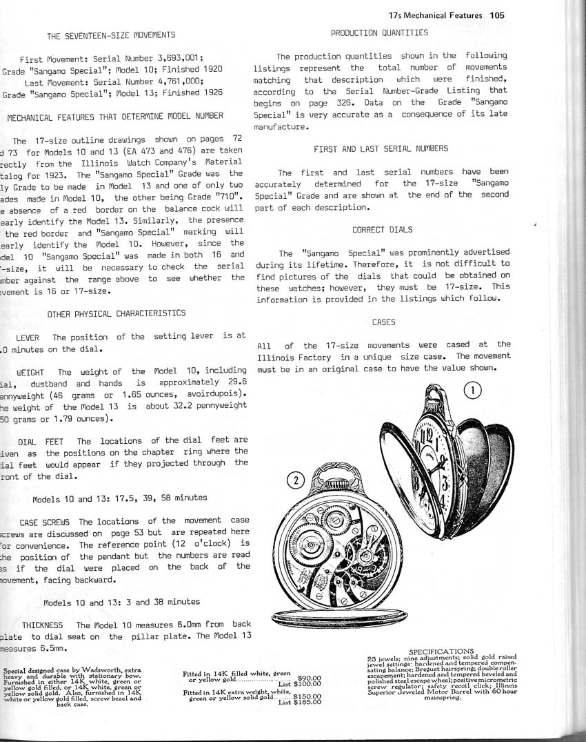

Edward
Below is a scan from the Meggard& Ehrhardt book
Sangamo

Tom,
Thank you for the reply and information.
It appears that only the Sangamo Special was made in 17 size. The Sangamo and some of the Sangamo Specials were made in 16 size.
I have found a Sangamo in what looks like the origional case. The case is very worn and has a replacement crown. I could possibly pick it up for a very reasonable price.
I was considering trying to find a period case and crown for it. Knowing that it would be very difficult to find a 17 size was a drawback to purchasing it.

Ed,
If you had the serial number it would help to determine if it is a 16 size and whether it is a model 9 or 10. The model 9 was not cased at the factory so a period correct case would do you just fine. If it is a model 10, in 16 or 17 size they came from the factory cased. An easy way to distinguish between the two is the model 9 had a jeweled barrel and the model 10 a motor barrel (three screws holding the winding barrel together). The 17 size was the same as the 16 size except it had a little larger diameter pillar plate for the larger dial.
