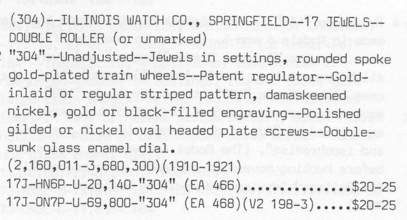

First off let me say this is a great site, found it while doing research into a watch that was given to me by my dad. Not sure where he got it, but I've had it for a while and never realized how old it actually was. So here's what I have.
The number inside the watch is 3255747, it says 17 jewels and on the back cover it has Star W.C. Co, Nickel 9078900. There are some #'s inscribed on the watch as well, looks like 47279. As near as I can tell the watch was made between 1918 and 1919, it's a pretty plain watch but I'm sure there is some sort of history to it. Here are some picture, not the greatest. Any additional info on the watch would be greatly appreciated. Thanks.

David AbbeWelcome to our group Jeremy. Your watch is a 1919 vintage Grade 304 model 7 Illinois 17 Jewel movemnt watch. This represents one of the most proven and serviceable Illinois movements. It was designed to give first class time service to the wearer with little concern over day to day use. The Illinois main reference explains a little more about this open face version of the 304 grade in the clip I added below. The most important part is this was a very popular grade of the post WWI era causing Illinois to produce nearly 70,000 of these for the consumer markt. That means the Jeweler's who sold them really liked them too!

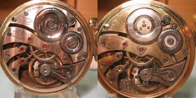

Steve MiddlesworthDavid,
Since you have gone through the trouble of marking up the false bridge, can you show a version of the true bridge for comparison. I am just curious so as I can spot the difference in the future.

Steve you always want to see stuff right!
I "juistr happen to have examples of a "4th bridge" and "false Bridge" handy. These are a 19 Jewel (4th bridge) and 23 Jewel (false bridge) Sangamo Specials;

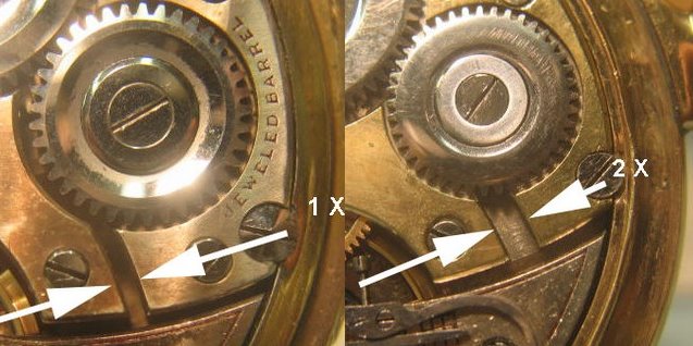

David AbbeThere are two "easy" ways to tell the difference.
1. The 4th bridge production was changed to "false" bridges at or about serial number 2,868,401.
2. The "gap" of the false bridge to the motor barrel bridge under the small winding wheel is about 2X the gap on the 4th bridge models.

Steve MiddlesworthDave,
Thanks, I have heard the term "false bridge" used before but never really understood it. Now I do. I also notice there is a little more bridge material, where the "Jeweled Barrel" is written, is this also a clue?
