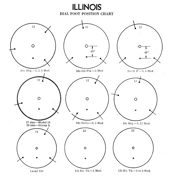

Here we have a nice "Dial Foot Position Chart" that will be very helpful.
Group "A", includes Models 6, 7, 9, 10, 11, 14, ----Grades 161, 163, 167, 169)
Note: This chart depicts the dial feet positions as if they projected through the dial front.

Robert,
I found that if you have a film positive made
of your dial diagram and turn the film positive over so it reads
wrong and then place your dial back side to the positive you
get quick indentifcation. At least this has worked for me.
April 18, 2006, 20:41
Bernard Levine
Clarification...place backside of the dial
behind film postive diagram positionig the
dial feet and and dial holes in correct position.

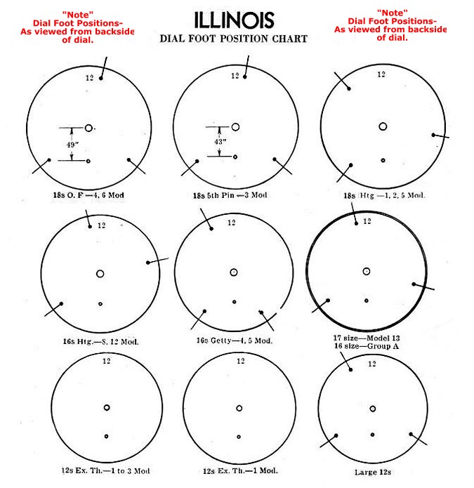

Hello Bernie,
The image below depicts the dial foot positions as viewed from backside of dial, as you described in your post, but composed a little different. Thank you very much for your suggestions.
