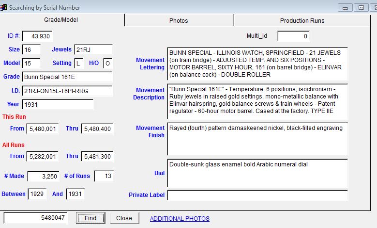

My database program shows this watch as a Type IIE. But, this watch doesn't have "Elinvar" on the balance cock. Thoughts?

Sometime back another watch from this run passed through eBay. It's number was 5480011. It to was a Bunn S. 161 Type II not marked Elinvar.
I have noticed other examples from the run 5,441,001-5,442,000, which the S/N list says should be Bunn S. 161E Type II-E, that are not marked Elinvar. Other inconsistencies between actual examples and the S/N list have been noticed from this time period. These involve both 161's and 163's.
Could these be errors in the S/N list?
