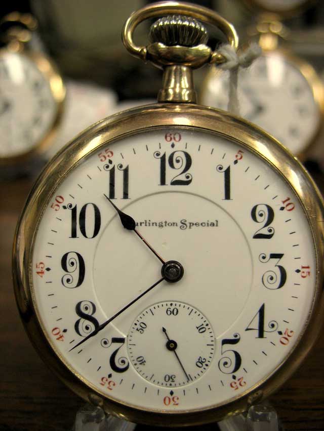

David AbbeRoger, You have the case which is often times the hardest thing to find. The dial and hands should look sort of like this 19J I just finished restoring tonight.

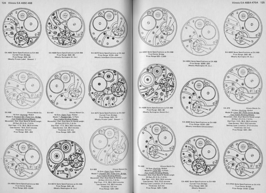

David AbbeRoger, I scanned 2 pages of the 8 or so pages in the gold "bible" filled with Townsend's 16 size Illinois plate cutting variations for their many, many movement styles. I am not at all surprised that Cooksey has little interest in illustrating all of these styles.

Roger J. NolfeThanks David!! I love that dial on your Burlington Special. Beautiful. The movements are very nice on these watches. Appreciate the info. (wanna trade

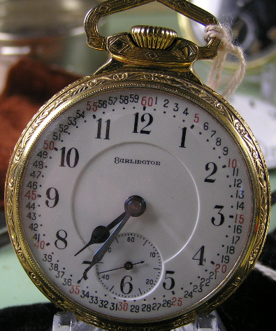

Steve MiddlesworthHere is the dial that replaced the one above....now if I could only find a nice case.

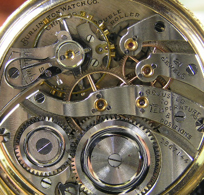

Steve MiddlesworthMine has the Grade "107" false bridge movement...

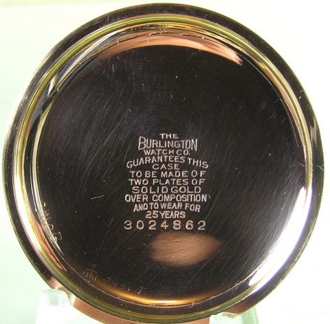

Steve MiddlesworthHere's an update....I just bought this nonworking 19 jewel in a Burlington case for $51.01. Not sure how great the case will be but it is an original Burlington case. It could use a new bow but it might be ok. The hands look original as well.

Roger J. NolfeSteve...Thanks for the offer of the dial. I think I would like to try and do something with it. Glad you found a case. You have the same grade 107 (thanks Andrea) that mine has.

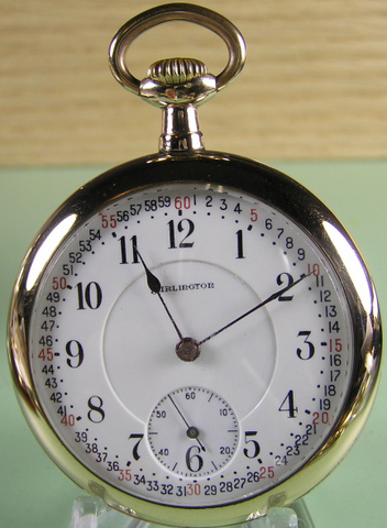

Steve MiddlesworthWell the donor watch arrived today. The dial was a mess and the balance staff was broken and the case looked to be a mess. I took the simichrome to it and worked on it and it ended up looking pretty nice after it was all said and done. Now my 21 jewel movement has been located into its new home. I even put the other hands on it so it should all be right now. It will need a new crystal however.

Steve Middlesworthand the final topping...its is officially a triple signed Burlington watch...
