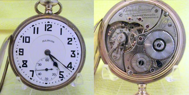

Bunn Spcl #3417621 Is Dial Correct?
This re-cased 21 jewel Bunn just came in with a double-sunk dial and hands that look like they have been together for a long time, but I expect the dial may have been a later replacement. Comments please?
May 15, 2008, 16:17
Donald Trumble
My recollection is of that dial being associated will the lesser 17 and 19 jewel Illinois watches rather than with the Bunns or Bunn Specials. And I believe that may also be true of the winding wheels.
Don
