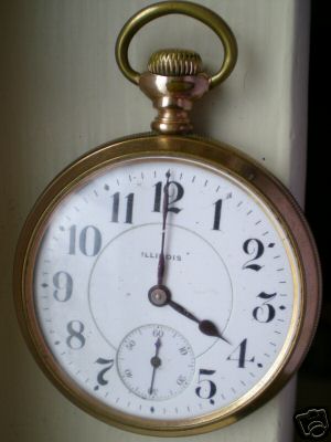

Thanks Edward. Would the one attached be correct also as the Illinois is straight (though not the same style dial) ?
Thanks again for the information,
Michael
August 30, 2013, 09:22
Edward L. Parsons, Jr.
That dial has a slightly later (bolder) version of the Bold Arabic hour font, but I'd say "close enough" since it still has the straight-line signature and is double-sunk.
