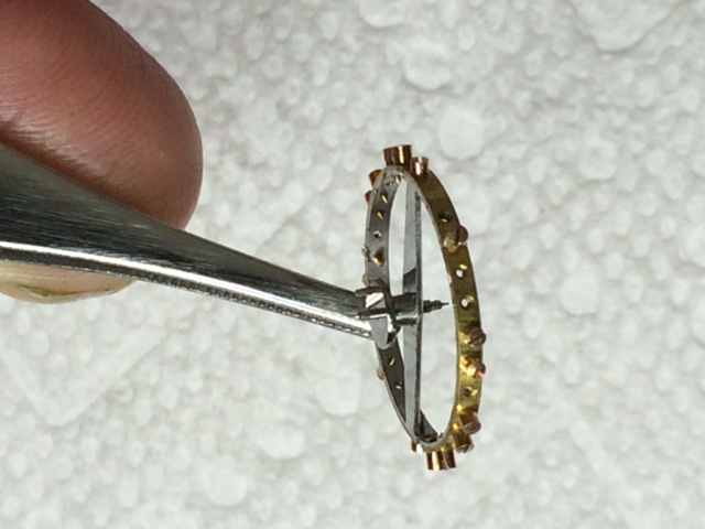

If you feel comfortable sharing a picture of the balance wheel we might be able to narrow your staff search down a little. The Model 6 came in DR/SR version. Staff # 47604 DR or 47605 SR (small collet) are the most common for the Model 6 from my search. Also, there is # 47632 which is a SR w/ large collet found in some Model 4 and 6.

William D. ShieSorry it took so long here is the balance

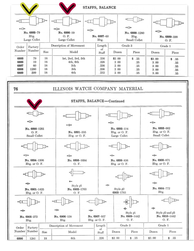

David AbbeThe movement is an Open Face model 6 single roller, so the collet is either a Open Face 6886 large or 6890 small collet. That "collet" is a function of the hole size in the cross arm of the balance wheel. I would suggest you remove the staff, measure the collet diameter on the staff and order the part number noting the diameter of the collet.
(fyi, I also marked the 6885 SR staff for Hunting movements. This WILL NOT work on your movement.)
