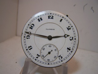

Recent 21 Jewel Bunn Special Fish Scale ??
Here it is Dial and hands look funny.

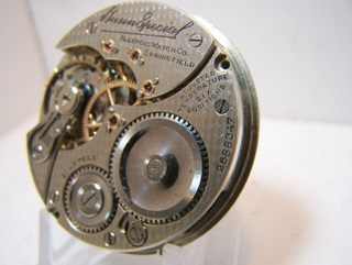

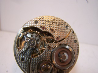

Eugene Buffard
The serial # is 2688347

Eugene Buffard
I had to replace the balance staff. As I was removing the roller table the roller jewel loosened up. I hate when I have to shellac them in.

Steve Middlesworth
Nice Fishscale patterned Bunn Special, those are one of my favorites. I would look for a straightline dial and hands for a more Railroad look. But then again, that may be an original makeup.
Steve

Eugene Buffard
I spoke to Lindell he feels the dial and hands are very possibly original. I'll leave it as I found it.

Mike LaForest
I have never seen a Bunn Special with a dial like this and especially those moon hands. I have to agree with Steve that it appears an unlikely original match.
