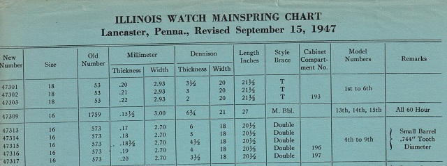

The book I have shows for a 16s Illinois model 5 the following;
47313 18x6x20.5
47314 18x5x20.5
47315 18x4.5x20.5
47316 18x4x20.5
47317 18x3.5x20.5
I am guessing they must have made barrels of different depths.

Those numbers in the center are the strength of the spring determined by the thickness.
Ed,
It's usually best if you replace the spring with the same thickness you find in the watch. I have a surplus of NOS Illinois 47317 I'll part with if that's what you need.

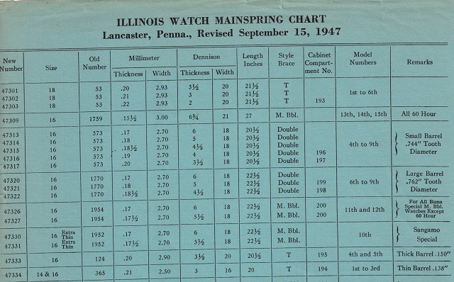

Those Dennison numbers are confusing. I like to use the MM scale and it's still difficult. Earlier today I took out a 47317, from a model 9, and replaced it with a 47315. The watch has synthetic oil and the stronger thicker spring was making the balance swing too far, knock, and run fast face down. Also, I haven't been able to find a 47321 which is longer, for the bigger diameter barrel but the short spring will work, just won't run as long.
RR
January 30, 2011, 21:18
Richard Romero
Tom,
You're right there is a thicker barrel for the model 4 and 5. The brace is different on the thicker barrels.
RR
January 30, 2011, 21:24
Thanks Richard
I found a place on the web that says they have the 47321 if you are interested, I think they wany 34.95 for it.
January 30, 2011, 23:23
Richard Romero
Ed, You're welcome.
The Thick Barrel is .150 inches and a regular one I just measured is about .141 inches. Typically higher jeweled watches have weaker springs and lower jewel counts require a stronger spring.
