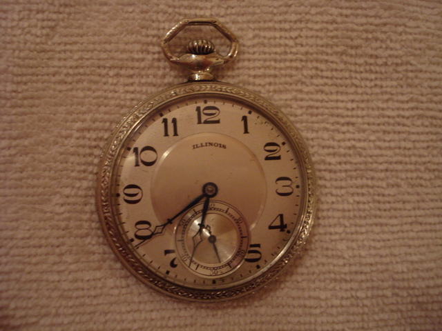

Newbie here. Father-in-law has terminal cancer. Last night he passed his Dad's pocket watch on to my wife. She'd like to know more about it. Serial # is 4823677. 17 Jewel. Inside plate measures 1.435" diameter. Does anyone know size & model, how to set the time (winds / runs well but stem won't pull up to set time), and is there anyone out there that could do a moderate cleaning of it? Wife would love to show it to her Dad after a little TLC. Thanks so much for any info / advice!

Regarding your watch, it is a 12 size, 17 jewel, model 3, grade 406 pocket watch. It is stem wound and pendant set meanining if you pull up on the crown (the winder) it should pop up and you can set the time push back down to wind. It was made in 1926.
If you have anymore questions feel free to ask. Your watch appears to be in very nice condition.

Your Illinois is a size 12, 17 jewel pendent set open face model 3 grade 405. It was made in 1926. This model was made from 1911-1929 for a total of 390,360.
The stem should pull out to set the time but it may be frozen in place from lack of use, do not try to force it, it should be serviced if it won't pull up.
It should have jewels in settings, gold beveled & polished center wheel & patent regulator.
The engraving on the movement should be either red or black filled.

Tom BrownWell Brian, looks like me & Steve have different grades. He is probably correct, he is a bigger Illinois expert than me, my info says 405.

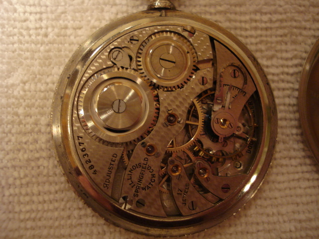

Brian HoffHere's a pic of the moevement for those that are curious.
Thanks again for the information.

Tom BrownNice looking watch Brian!

Jerry KingThat is a great looking watch, Brian, and one that you will want to keep for years to come....
It will give you and your wife great pleasure and it is good that your first thought was to clean it up....it's not bad now by any means....
Steve and Tom have given you some great information and I certainly can vouch for Chris and his work....You will not recognize your watch when you receive it back, it will look as when your wife's grandfather first bought it many years ago....Chris restored my grandfather's Elgin and I could not believe the difference he made in the watch....

Steve MiddlesworthTom,
Typo on my part....it is a grade 405.
