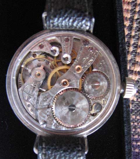

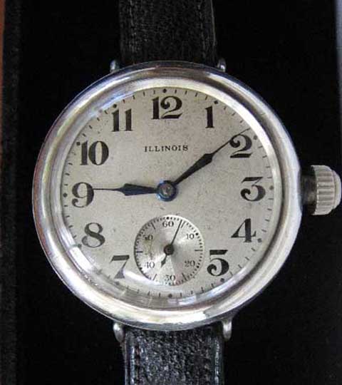

This watch appears to be an Illinois Off Duty, but there are some subtle differences. The numerals are slightly smaller, and the case is different. This is a common 17j grade 307 #5,339,373 in an Illinois Watch Co. Sterling Silver case. Can anyone tell me if this is an Off Duty model? If not, what is it?

Hi Stephen
According to Fredric J. Friedberg's book "The Illinois Watch" "The Life and Times of a Great American Watch Company." page 176 shows 2 pictures of the Off Duty ( one of the dials has a red 12 that adds $300 to the watch value)& both have 14k WGF Wadsworth case # 211 (Stars on the bezel & back of the watch, same case is used on the much sought after Skyway). Your dial above differs from the #8083 dial in that the Off Duty dial has a distinct knob on the end of the numbers two. In my humble opinion, your watch does not have the #8083 dial, nor the Wadsworth
# 211 case. I did not see your watch in the Illinois book. NOTE: The #211 Wadsworth case is also used on the Illinois Skyway & Greyhound.

Rick Vess

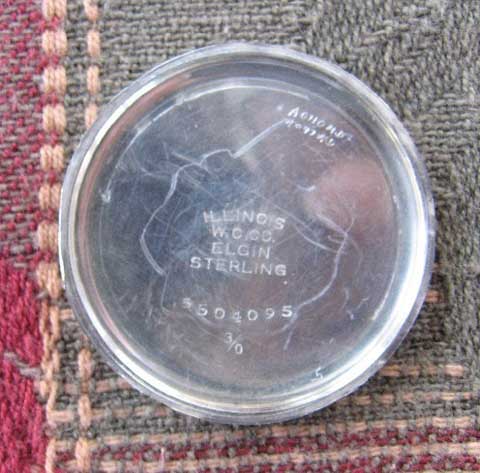

As a bit obsessed Illinois collector, the value of this watch is likely no where near an Off Duty. Frankly, IF I had to bet, I would guess that this was likely assembled from various parts, and the case MAY not have originally contained an Illinois movement -- perhaps a PW conversion, but who knows. Please confirm the exact wording how the back is stamped with "Illinois". That said, it is attractive, and the dial seems to be an original dial with an original silvered second track.

November 10, 2008, 12:07
Steve Gossard
Here is the watch and case marks:

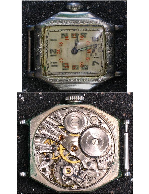

November 10, 2008, 12:08
Steve Gossard
Here is the movement:
March 17, 2009, 13:16
Bill Carlson
I just wanted to add this photo of an Illinois 307 wristwatch that I have for the record. The case is a Star Stellar. The 24 hour numbers have been added to the crystal. Very crude.!

That is very interesting. I like the way that looks. I also have an early swiss watch with applied 24 hours. They are stuck on like a decal.
