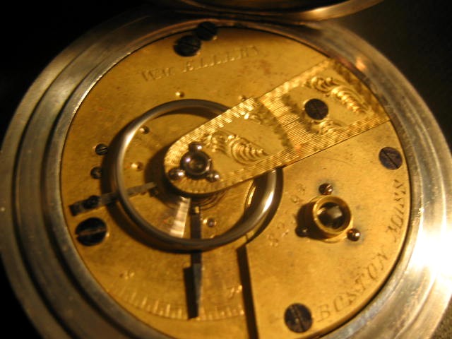

Steve, some of the early American Watch Co (Waltham) movements had swiss-made (or copied) solid Balance wheels (pic) and were also somewhat "adjusted" but mostly for position.
Some later watches like some Elgins and low cost (export?) Walthams had solid brass uncut wheels with balance weights added to bring them to the correct rate for the Balance (hair) spring they had. These were never adjusted for anything at all.
