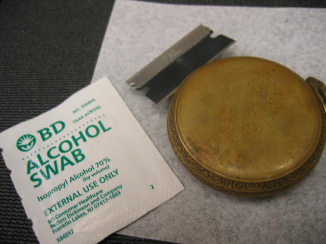

David AbbeJohn, I suggest that you help assemble a pictorial listing of the "Many Miraculous Uses of Rodico", one of which (I discovered) is to remove stubborn case covers and Bezels;
Step 1. CAREFULLY run a single edge razor around the seam and add isopropyl to loosen the junk locking the case and help lube the razor.

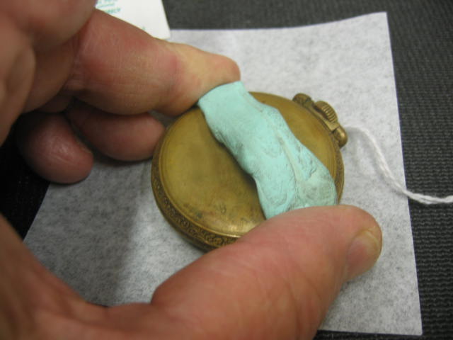

David AbbeStep #2; Knead a lump of old Rodico, lay it across the case back or cover, then squeeze and TWIST!
March 16, 2008, 14:43
David AbbeRodico really "Gets a Grip on Things", and it is super easy to remove.
