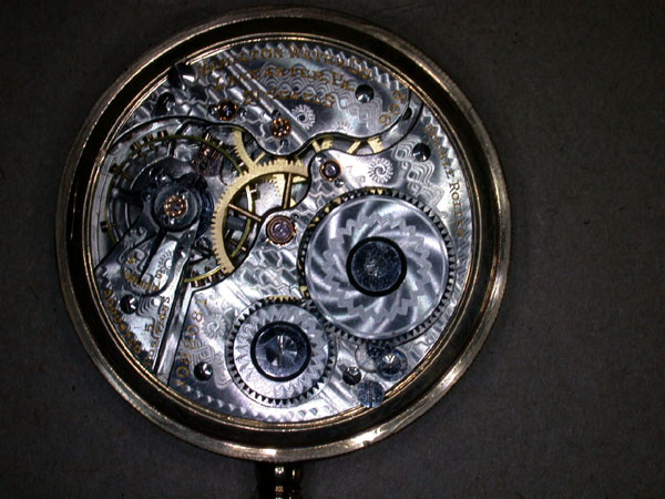

Well, I have to declare the use of the ring light a failure. Here is an image using the built in flash on my Nikon 995.

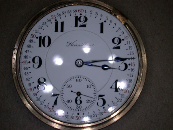

Here is one taken with the ring light. How do I get rid of the refltions?

Here is the movement using the ring light.

Just a suggestion. If there is enough clearance, place the lens right in the opening of the top of a plastic milk jug, so that the ring lights are outside of the jug. This might diffuse the ringlight enough that the lighting is more even, eliminating the hotspots that they are creating.

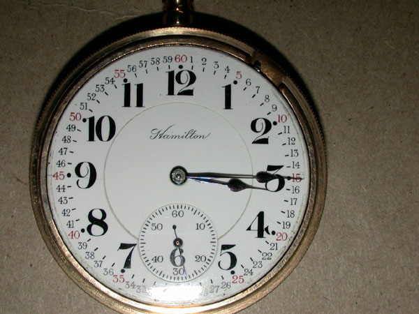

Ed: I followed your advice and made a diffuser from a plastic milk jug. I lit it with two lamps from the left and right. I have posted the pictures in the photo gallery. I would appreciate your comments.

The new scans are definitly an improvement, but I would make a couple of suggestions.
First, if you are using a tripod or copy stand where camera shake is not a problem, I would set my camera to "Aperture Priority" and stop the camera down to about two stops from the smallest aperture (the highest f/stop number). This will increase your depth of field and allow a greater depth to be in sharp focus.
Second, phtograph the watch when it is not running, to eliminate any vibration due to the moving balance and to allow the balance to be in sharp focus.
Third, Use an editing program to correct things like color balance, brightness and contrast.
As an example, I took one of your scans and made some quick changes to it, with the following result.
http://static.flickr.com/33/45923015_19dcd82356.jpg
I still feel that you need more light diffusion. Don't use any ceiling lights that may create hotspots coming in from the diffuser opening on the top. Make sure that all of the side lighting is going through the milk carton, and have the lights angled down slightly to illuminate the bottom portions of the movement.

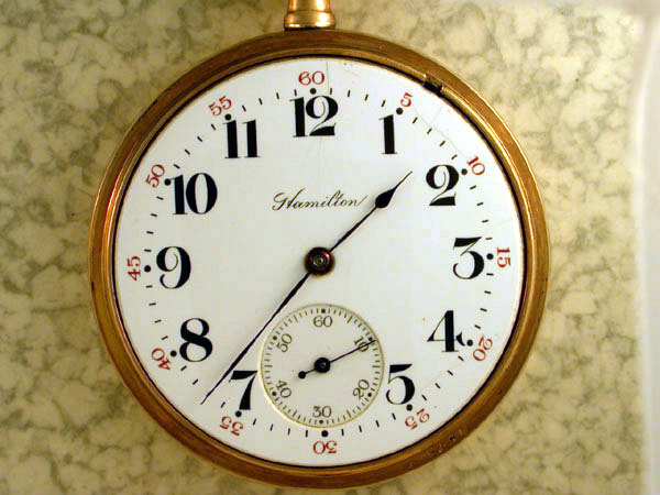

Ed: I fooled around with the picture of the dial. I like the results which made the dial whiter.

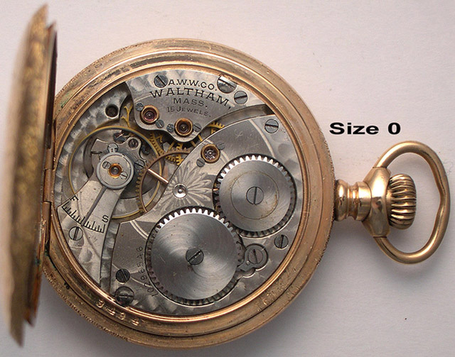

It has been a long time since 'Lighting' was discussed in this sub-forum, and since everyone likes to see pictures, I thought I would post three pictures of what seems to work for me. This set-up idea came from this forum. First the picture itself and them the setup I used to take it:

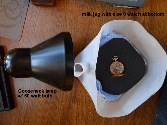

Next the set-up (side view)....

I like this method because it it so cheap and simple.
A digital camera with a macro lens capability (for taking close-ups) is a necessity. The simple, cigarette pack size cameras out today often have macro lenses built in.
Next, unless you have software for manipulating photos (cropping, re-sizing, etc), you will want to fill the view finder with your subject as much as you can yet keeping your subject in focus. Use wide angle settings, no telephoto.
If you shake, you will need a tripod and a camera with either a 10 second delay after you press the shutter button, or a camera with cable release capability; either way, you'll want to use a tripod if you shake. Take several photos and use only your best. Never let'em see your mistakes!
The picture above was taken with a Nikon Coolpix S570 on sale yesterday for $149.00 at Office Max, BestBuy and many more outlets.
