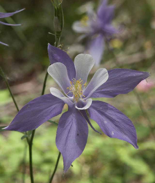

Very little of the foreground and background in focus. Taken with a large f stop. Colorado Columbine, our state flower.

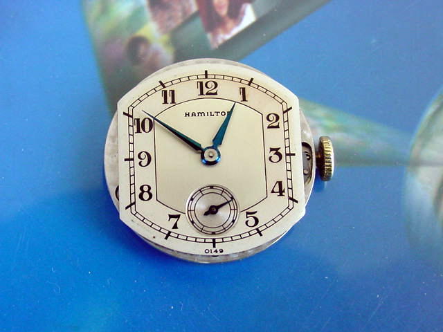

here is picture taken freehand with no special light using the steady shot feature and on macro mode at about 2 inches distance..
September 07, 2005, 20:49
Sam Williamson
Great shot Samie! What size file did you use?
Sam Williamson
September 08, 2005, 22:08
Samie L. Smith
Sam this picture was taken on a 640x480 setting on the image size, using macro mode and steady shot..when i downloaded it to the computer it was ready to email or post up,, the file size of the picture is 39k...
