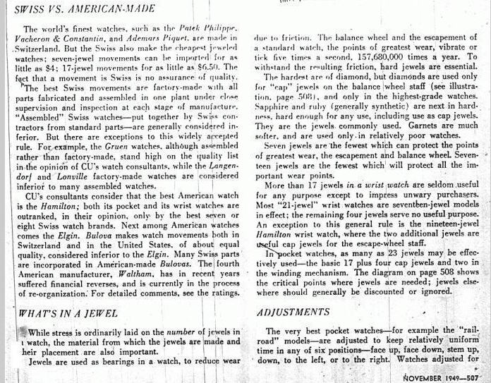

November 12, 2005, 14:09
Jessica Lane
This interesting paragraph is from an article published in 1949 in Consumers' Union. The article concerned the value or quality of various watches then on the US market. Very interesting article.
The site of the article is:
http://filebox.vt.edu/users/zbortolo/watches/Page_2.html
One of the interesting point in the article, which it should be emphasized was published in 1949, is its rating of Swiss vs. American-made watches, and its statement that, at that time, jeweled pocket watches were more reliable for accuracy and durability than wristwatches.
