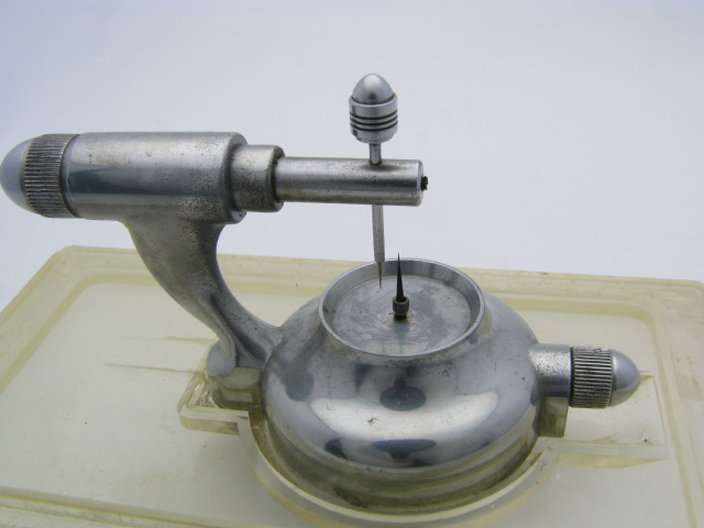

I have seen all kind of gizmo’s to do hairspring work that often get big money, none I have seen yet are of any use, here is one I was given, you can rotate the lower pin and drive the other in and out, suppose to untangle hairspring, it caused more problems than its worth, cant beat two good well shaped pair of tweezers.
