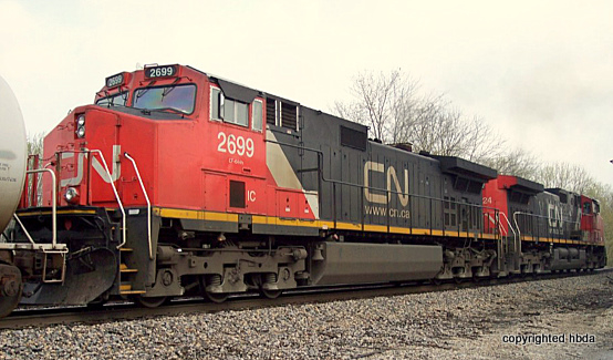

David AbbeWhen the rod fails on a "Big-un"!
When a "Gremlin" hits a Locomotive
Shortly before this picture was taken, whilst working under load, 2699 experienced what is known in the trade as a catastrophic uncontained engine failure. The train was passing the town of Independence, La at the time.

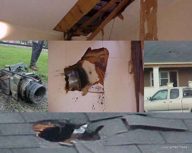

January 21, 2011, 13:48
David AbbeThe first picture below shows that one of the 16 cylinder packs that form the engine was ejected through the engine bay body side and thrown clear of the locomotive.
In addition to this the piston from that cylinder was thrown free by the force of the failure. It was ejected so violently that it traveled through the air and crashed through the roof of a nearby home where it imbedded itself in an interior wall.
January 21, 2011, 17:21
Edward L. Parsons, Jr.As a mechanical engineer and a former diesel engine designer, I find this type of spectacular engine failure interesting.
The ejection of the entire cylinder package as well as the piston itself in addition to breaking the connecting rod, involves a huge release of energy. This indicates to me that the engine must have been running for some time in a "failed" condition, a seized rod bearing or something of the like, before the final explosion.
These kinds of failures are normally very noisy, but this one was apparently not noticed until the final catastrophic phase.
January 21, 2011, 20:38
Theodore J. Brown Sr.Being a Diesel mechanic myself, I've seen acouple of engines "grenade" like that, but it's hard to believe it wasn't rapping real bad before this happened...The block and crankshaft must be in good shape after that!I once worked on a Caterpillar 3508 generator set engine that threw a rod with no warning, it destroyed the $27,000 cyl. block.This will cost the Railroad big money! Take care, Ted.
January 21, 2011, 20:47
David AbbeI was told it was a rod failure, but is it possible that it "swallowed a valve"?
January 21, 2011, 21:09
Theodore J. Brown Sr.Hi Dave, that motor could have swallowed a valve,that would happen with no warning.In a big diesel like that, probably running at around 1800 RPM, and a valve hung open or broke off, that would bend or break the rod for sure.There's NO room in the combustion chamber for anything!Imagine the force it took to throw that cylinder assembly thru the steel hoodside, and far enough to hit the house.I would'nt want to have been standing in that engine compartment!Great story and pictures, Thanks for sharing It!...Ted.

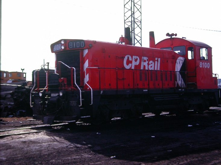

January 26, 2011, 19:52
Larry BuchanRearview of a 8100 showing the Windows, battery box, ladders, and leading footboard.

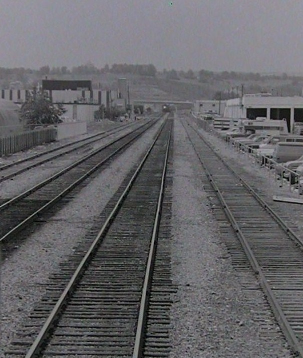

January 26, 2011, 19:56
Larry BuchanThe Scene of the Crime, Left track "B" alley west of eighth Street Southwest Calgary, Alberta.
