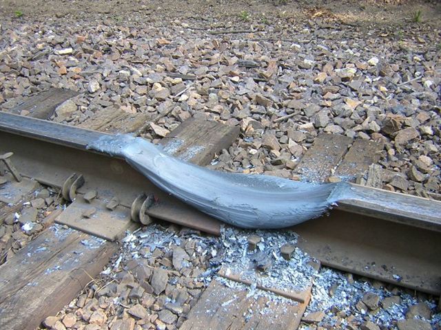

This is what happens when you leave a locomotive in throttle 8 for a few hours when the train brakes are in full application, or in a stall situation.

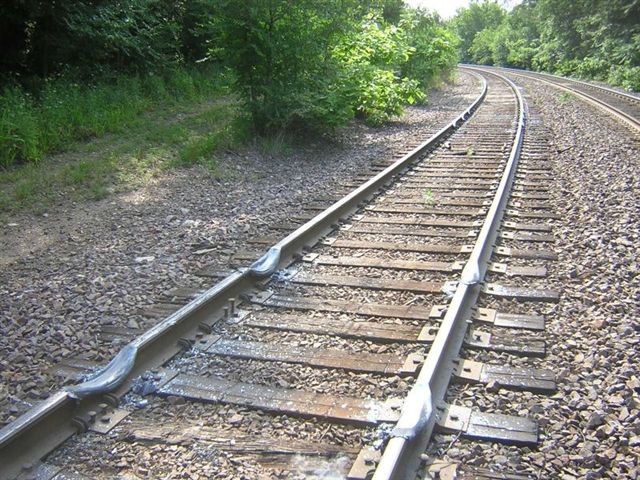

Larry BuchanYou can see two sets of axles that did this track damage in the foreground, and the three sets from the other end of the locomotive in the distance.

Edward L. Parsons, Jr.Amazing! I would have thought there would be some kind of sensors & controls on the locomotive to prevent that from happening.
Looks like it got pretty hot, to deform the rail that way. I expect someone got in trouble over that.
May 19, 2011, 12:38
Jon HartingWhen I was a SP hostler in L.A I seem to remember that the wheelslip indicators on any one traction motor would have dropped the load.

Larry BuchanHello Jon:
CPR pioneered locotrol (mid-train remote locomotives controlled by radio signals) in the mid-1960s, these remote locomotives or "slave" units as they were called could be controlled independently from the lead or "master" locomotive. And despite of the wheel slip indicators, what happened here is quite possible if set up in independent motoring, with this technology, we used to run grain, potash, and bulk sulfur trains of about 112 cars with the "slaves" located two thirds back from the "master" units when working through the undulating conditions in the Rocky mountains west of Calgary you could have the "slaves" in throttle 2 with the "master" in throttle 8, one problem we did have was a loss of continuity in the downgrade spiral tunnels, this would happen when the "slaves" and "master" lost communication with one another, so when we had the grade balanced the "slaves" would be usually placed in dynamic brake 6 in independent motoring, as when in multiple unit position the "slaves" would automatically go to idle position when they entered the tunnel and continuity was lost.
Ed I don't know all the particulars of what happened in this situation, but I'm sure somebody would be on the carpet answering questions if it was an employee error.

Bill CarlsonYou can also imagine what the trucks looked like also. BLUE
It seems to me I have seen photos like this quite a few years ago and the engine and wheel truck were together on the side track getting new wheels.

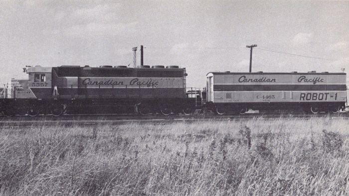

Here is another picture of Canadian Pacific Robot 1 with the original Master locomotive CPR 5775 that was used for the initial testing, the Robot car was originally express baggage car No. 4465 the conversion including installing two oil furnaces to keep the electronics from freezing up in the winter conditions of the Canadian mountain ranges, it was also fitted with storage cupboards, a table and two bunks for the technicians who were to monitor and service the equipment. This was taken at Alyth Shops in Calgary when it was being set up with its electronics circa September 1967.

Bill CarlsonThanks Larry,
Very interesting stuff. Just think, what fit in the reefer car back then probably goes in a couple shoe boxes now.
Good pictures.

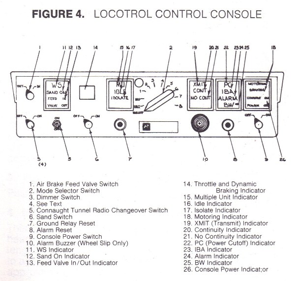

Here is a photo from my rulebook showing a Locotrol 1 console from a master unit.
