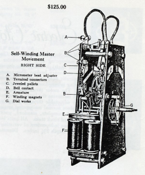

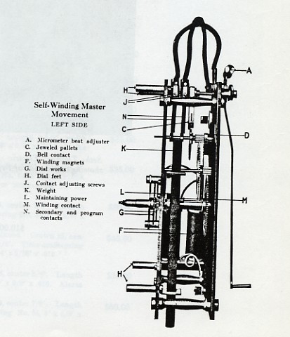

Steve, Here are some photos from the Seth Thomas book by Tran.
I have emailed you with the full text of the page describing its operation. There may be a clue there for you.
The following pictures are from Tran's book.
Tom Seymour

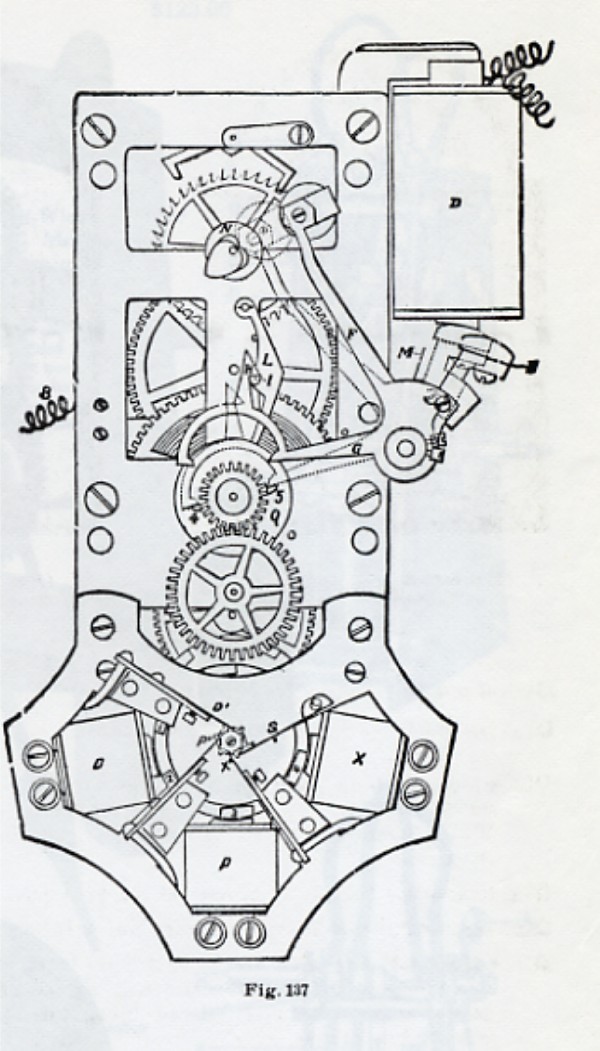

November 19, 2003, 15:36
Tom Seymour
Other illustrations from the book.
Tom Seymour

November 19, 2003, 15:37
Tom Seymour
One more picture.
Tom Seymour
NAWCC# 41293
IHC Executive V.P.

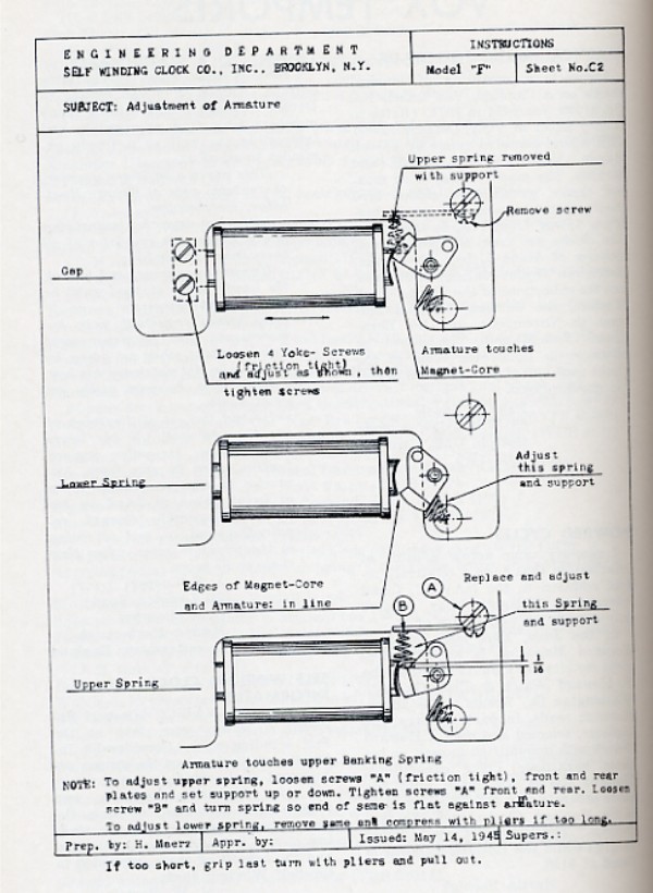

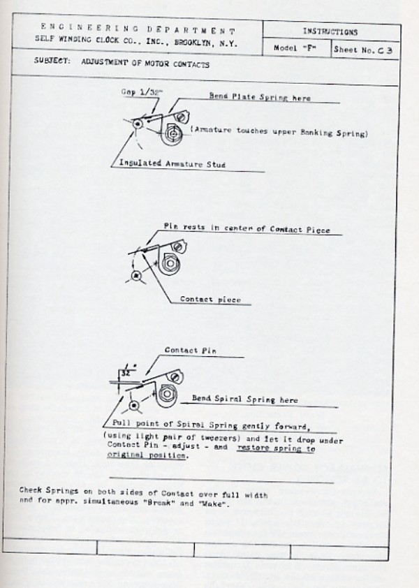

November 19, 2003, 23:05
Tom Seymour
Steve,
Here are a couple more drawings. These are from Bulletin Whole No. 198, pg. 77
There is another promising lead: Whole No. 159, pg. 215, and article entitled Self Winding Clock Co., Explanation of Mechanism.
There are many references in the Bulletin index, but many are just questions and short answers.
You may want to check those out.
Tom Seymour
