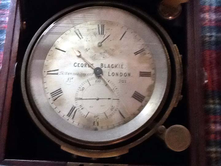

Does anyone have a safe method for cleaning what looks like oxidation from maybe years of finger prints off the face of a Marine chronometer without damaging the underlying surface?
March 06, 2013, 22:07
Michael Weiford
On silvered dials I have used Cream of Tarter (found in the spices at your local grocery). I mix it with water to form a paste and use a soft bristle toothbrush to gently remove the dirt.
Up to this point it has never removed any paint or silver from the dial, but be careful as it is abrasive.
