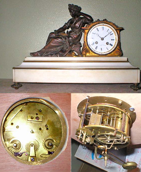

Thanks again for the helpful comments. I am trying to attach some pictures to this message which will show the pendulum system. The clock has been running since this conversation started so I think the time works are all intact. That was my main concern before disassembly to replace some of the chime train. I was able to find a complete movement on EBAY and I’ll receive it in a few days. As the pictures show the clock house and statue are very tarnished. I now have all the pieces apart. The statue is in five parts, all separate castings. Quite interesting how these things are made. The statue and house are also very dirty from probably smoke since these clocks were often set on fireplace mantels. Since they are not easy to move to adjust the pendulum length the string suspension allowed an easy adjustment from the front of the clock. My clock has four screw adjustable feet so leveling should be straightforward. I don’t see any adjustment on Ged’s clock. A very pretty example of French marble cased mantle clocks.
Regards, james

Jim sent along his pictures, we merged the three and placed them in his previous post.
Take another look at Jim's January 28th post.
