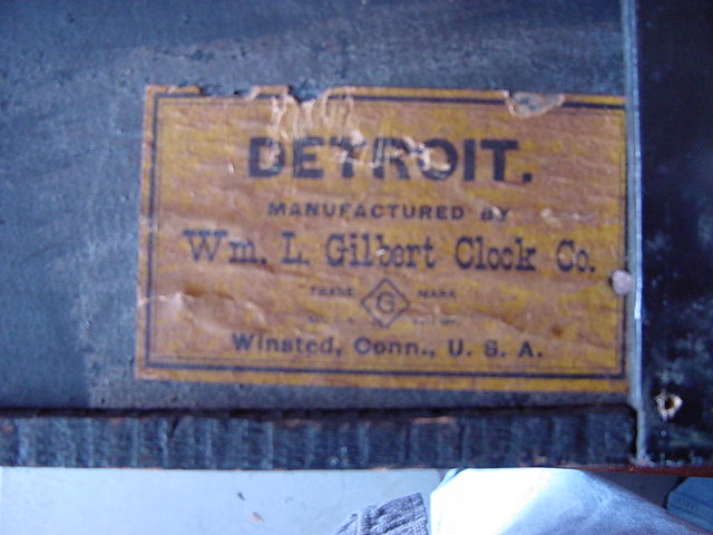

I recently figured out the mechanical problem on my gilbert mantle clock and have decided to tackle the case. I stripped off a small piece of paper on the bottom of the clock and low and behold I found the gilbert label. It is a detroit model.

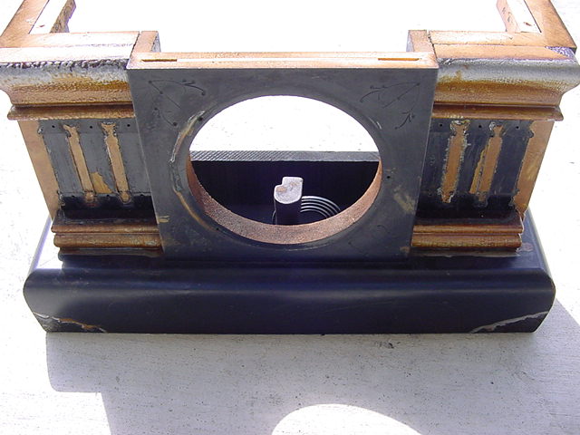

Here is my question.. I would like to repaint this clock to it's original color. The case itself is black however the small columns, ornamental side pieces and feet have all been repainted in some god awful silver, gold color. Can anyone tell me the original color for these items and advise me of some good paint for this process.
this was a nice case until some moron attempted to repaint the small stuff with a can of spray paint. I have the case down to its bare form and am starting to strip some of the spray paint from the metal items. There are small scroll marks in the wood and therefor I will be using a chemical strip with very light paper were needed.

Bruce,
I looked in my Gilbert references and could not find a "Detroit" model. Could you post a picture? Or send it to me and I can post it for you.

Hi Tom,
Here are a couple pictures of the clock.. Let me know if you need a picture of the movement
February 23, 2004, 16:26
Bruce Byrd
and the case
