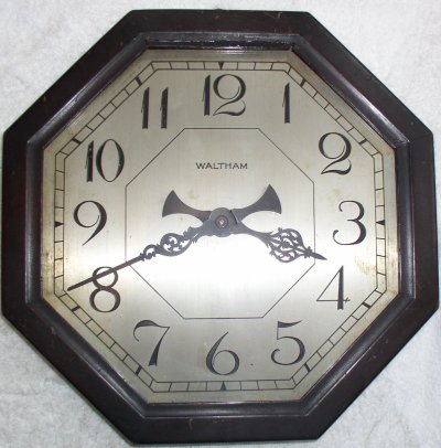

Wayne C. Anderson
Waltham Clock
Would anyone have any information about this type of Waltham wall clock? Inside there appears to be a small movement, with a shaft to the side for winding and setting. Thanks

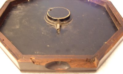

Wayne C. Anderson
With the metal back cover removed. Its missing the shaft and knob.

Tom Seymour
Waltham Clock Company began in 1897, in Waltham, Mass. they mostly made tall case clocks. They did have wall regulators and others as well. Many of the tall case clocks were top of the line with tubular bells.
In 1913 the Waltham Clock Company was bnought out by Waltham Watch Company. For about 2 years it was known as Waltham Watch and Clock Company. After that all production was under the Waltham Watch co. name.
In the 20s production shifted from tall case clocks to mantel and wall clocks. Pendulum clock production ended during the great depression, electrics continued through the 30s.
The above information is from American clocks by Tran Duy Ly.
I like the look of that clock. The hands are especially attractive. I could not find any with similar hands in those Walthams pictured in the book.
Maybe some of the watch folk can tell us if that is a watch movement in that clock. Could you get a picture of the movement?

Jerry Treiman
This is one of many, many varieties of desk and wall clocks that Waltham made using their 37-size, double-mainspring, 8-day movement. It has a lever escapement and from 7 to 15 jewels. I have seen them in various metal and wood cases from plain to fancy. This movement was also commonly used for automobile clocks and folding travel clocks. Mel Kaye has written some great articles on these in recent Bulletins (see your October 2001 and April 2002 issues).

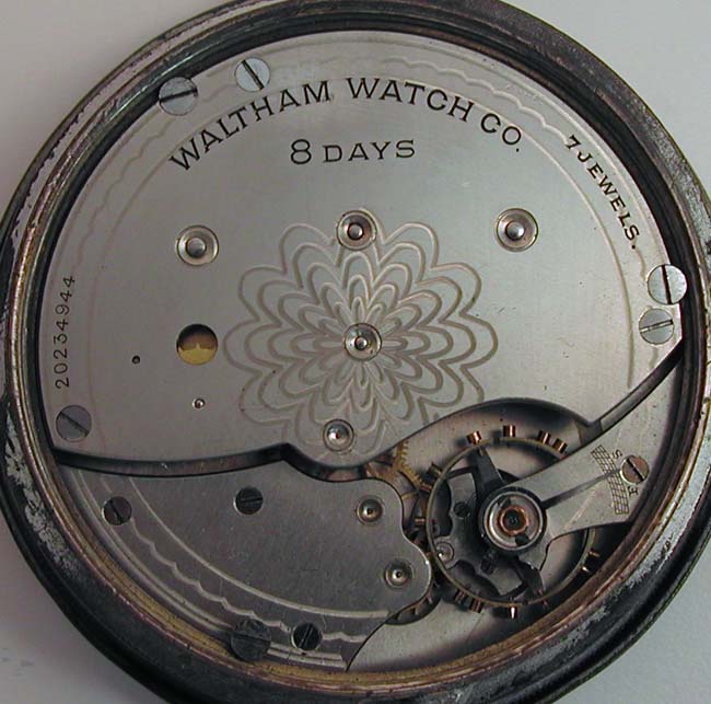

Jerry Treiman
Here is a typical movement (this from an automobile dashboard clock) ~5.5 cm across the back

Jerry,
Thanks for the info and the lead to the articles in the Bulletin. The discussion of "Is it a clock or a watch" was very interesting. It got into some of the fundamental differences between clocks and watches.
If I read it correctly, this is a clock movement because of its size. Its size, however, is described in watch size terms. It is not, however, made like a clock, with generous spacing and end shake. It is made like a watch with close tolerances and "dense" in terms of the space it occupies.

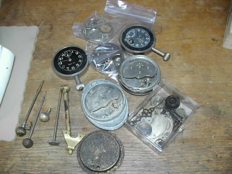

George R. Edwards
Wayne...I found these in my 37 size misc box tonight. Maybe one of these shafts and knobs is what you need. Let's see a close-up of the winding arbor and measure the length to see if any of these may fit.

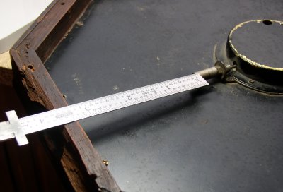

Wayne C. Anderson
Tom & Geo
Thanks for the information - the distance from the adapter to the edge of the clock is approx 4". The extension appears to thread into the adapter - The wood is damaged where the winding/setting knob would have been - I am going to remove the movement and take photo's soon - then I will decide if I will be able to repair it, or should I pass it on to some else with better repair skills than mine (mine are very limited).

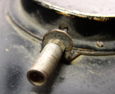

Wayne C. Anderson
Geo
A close up of the arbor (adapter) - the extension screws into the adapter. Thanks
