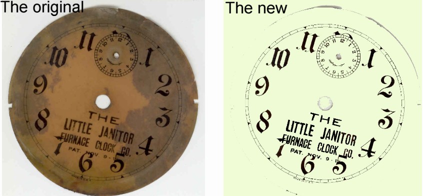

From the appearace of the dial...I think it was an oil furnace!!! Were it not for a "rip" in it which shows fibers...the dial is so soaked with oil that it has the appearance of celluloid!
Unless its a different material than I know of. It actually is working now, everything is cleaned. I only need to polish the bell,case etc. and put it back together
greg
