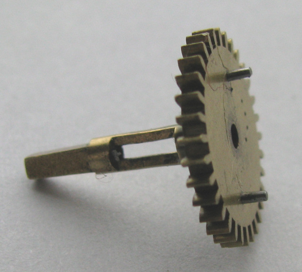

David, the clock I have here is a countwheel strike mechanism, which is different to yours, which appears to be a rack strike type.
The wheel shown below is very similar to the type Eddie mentioned, except the pins are equidistant from the centre.
Out of curiousity, was the strike timing ok before you had the dial and hands off during the restoration? and did everything go back together as it should have? or maybe something got bent during reassembly?
Best regards
John
Minute wheel

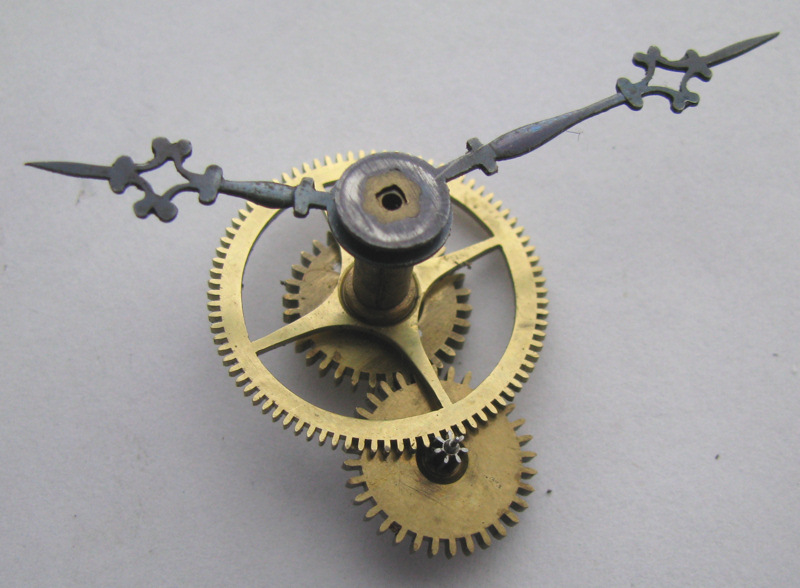

John Woolsey
This shows the orientation of the wheels and hands (loosely plonked together).
John.

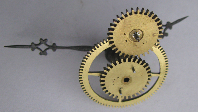

John Woolsey
From the front.
John
Motionwork Front
