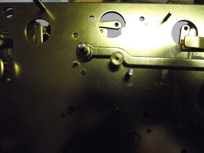

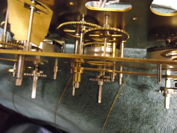

I am working on an Urgos 9 tube movement. If someone has dissassembled one of these movements, how do you remove the intermediate gear on the front of the escape wheel.

Ken Snowdenmeant to include this picture

Patrick Wallin3 tools will do it. A 3lbs hand held sledge, a punch and a good anvil.

Dave Turnerquote:
Or, if you want to be able to put it back together,
you might try a small puller, or some prying levers, along with a little penetrating oil.
And/or, apply some tension to a puller and then smack it sharply with a hammer.

Paul J. WilliamsThat wheel/gear appears to be brass. If pressed on maybe some "reasonable" careful heating may reduce the pressure needed. When heated brass will expand at a greater rate than steel, which would be an advantage in this case.
I've had no experience with this movement.
December 13, 2014, 00:56
Paul J. WilliamsBefore the prying commences,It could be threaded.
If so, is locktite present , any red residue visible ? A little heat will soften it.

David E. Booth, Jr.If my memory is not lying to me, that pinon is pressed on, and the arbor is tapered. While you have the clock apart, you would be well advised to bush every pivot hole with the new ball-bearing bushing. Pivots on all Urgos and Hermele clocks were made with soft steel, that was chrome plated. The pivots cannot be polished, because burnishing them removes the plating.

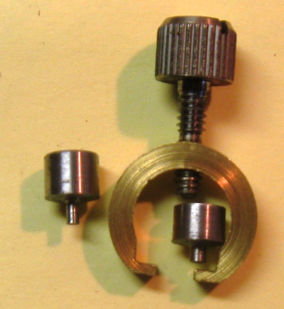

David E. Booth, Jr.My memory is correct. I dug through my odd specialized tool bin, and found a puller I made from a piece of bronze pipe and a ham radio tuning lock screw. I used it for a couple of years, when I was running a clock repair business.
One of the center adapters fits Urgos, the other fits Hermle. They are both counter bored to take the end of the thumb screw.
