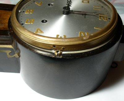

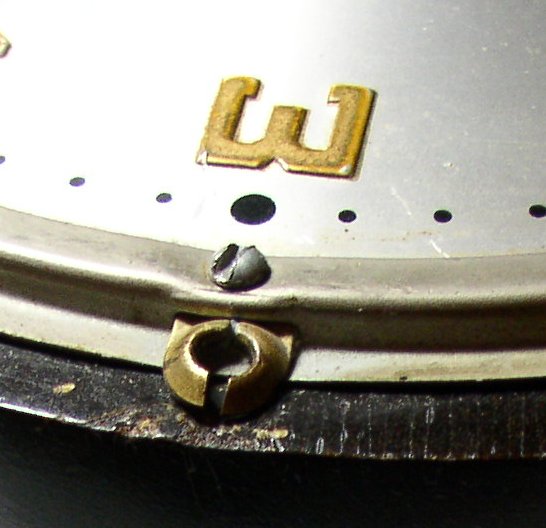

On our last Flea Market/Antique shop outing, my wife spotted this Gilbert Banjo Clock and decided it should come home with us.  But its missing part of the catch for the outer glass door, would anyone know where replacements might be obtained?
Thanks for any information.

Tom SeymourWayne,
I've been looking through the Gilbert books and cannot get a clear picture of what was original.  None of the ones I have seen look like yours.  It could be just not in the books (Tran's and others) that I have.
Do you get the feeling that the parts that are there, namely, the circular bit, is original?
I have also looked through a few catalogues.  Merritt's has a bezel latch that requires no soldering to install.
Otherwise you might keep you eye out for an old junk case with a good bezel.

Tom SeymourWayne, Thanks for the good picture of the bezel.  I  thinkt the outfit from Merritts (page 41) could be adapted to fit  your bezel.  I don't know what the outer bezel looks like.
Many of the banjos are removed through the back. If you remove the dial you will fins solid wood with holes for hands and winding arbors.  I don't remember specifically about that one.

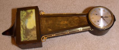

Wayne C. AndersonTom,
  This is a photo of the whole clock - less the eagle on the top - it appears to run for a few minutes and then stop, but its missing the winding key - I think its 3mm size - on the dail is market "Gilbert 1807".  I do not think the glass picture is original.

Tom SeymourWayne,
You are probably aware, but others who see the "1807" on the dial think that is a production date.  I does indicate that it was made no earlier than the 20s when Gilbert started putting "1807" on the dials.  The 1807 date refers to the first clock factory (Samuel Hoadley & Co.)on the site of the Gilbert factory. the gilbert clock company was not formed until 1871.
Is that a lever movement in that one?

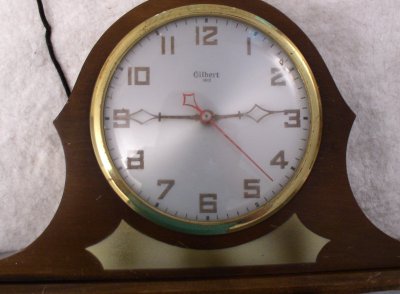

  Thanks again for the information.  This is the Gilbert 1807 Electric clock that I found at a flea market this morning.
