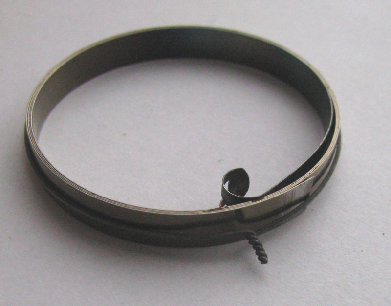

Alternatively, wrap some strong wire around the spring and twist the ends tight to hold it under pressure - do that on both sides of the spring though if it's a wide one, as it can 'cone' and twang the wire off if it's off centre!

Twisted wire retainer.
Wire retainer

I'll make up a couple of hoops for later work but the problem with this one is that it's a broken "open" spring, i.e. with no barrel.
It's currently sprung out to about 3" dia with all the slack on one side. If I try to rewind the spring the broken end will slap around as it clears the various pinions etc and do more damage to the movement.
I guess I could open a suitably sized Jubilee (hose) clip, fiddle that around the spring, re-assemble the clip and then gradually tighten it as I re-wound the spring. This should keep the spring in check and avoid doing damage to me or the movement.
What do you think?

Dick, I wondered if it was one of those open sprung jobs, not had a lot to do with them.
Can you use wire and twistlock pliers and just bind the coils up tight in a few places around the spring?
Might just hold it enough to be able to get the thing out!
If you can get at the loose end, you could also bend it back and trap it under one of the wire loops to stop it unravelling.
Heck, in desperation, you could even zap it with a MIG welder on the edges, it's a junk spring anyway, just make sure you earth the machine on the spring! Big Grin

Thanks for that John,
In the end I used wire as you suggested and it came out as quiet as a lamb!
