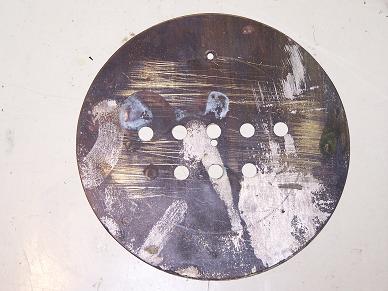

J. Bruce WeeksHere's the back of the dial. The blackening is why I assume this is actual silver plating.

Robert Michael FullertonJ.B.,whatever you do don't be tempted to use an abrasive polish on your old dial.In fact I would highly recommend you not use any type of polish,abrasive or non abrasive.Believe me,take it from someone who learned the hard way years ago.Soap and water is as far as I'd carry it unless you want a nice metal plate instead of a dial.
My advice to you is to send that dial to Mrs Martha Smallwood down in Georgia.Nobody does it better and she's very reasonable.Figure a three month turnaround but it's worth the wait.
The Dial House
Dallas,Georgia
1-(770)-445-2287
www.dialhouse.net Best of luck with your restoration.
Respectfully,Bob Fullerton

J. Bruce WeeksThanks, Bob,
I'll have to have Martha quote it and see if the owner wants to go that far. He is doing a restoration of the car and lots of brass polishing. I have the dash clock too.
