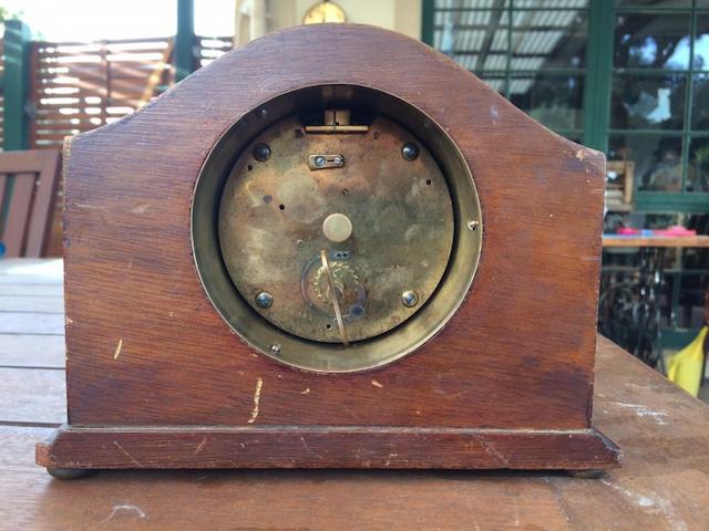

Hi all,
Can anyone provide some guidance as to how to get the movement out of this Buren Mantle Clock? I have tried without success. In my defense I normally work on pocket watches and am only cleaning and servicing this clock as a favour for a friend.
Thanks in advance for your help.
Cheers
Geoff

Geoff Osborne
Front of clock.
May 02, 2018, 13:41
Eddie G. Hines
HELLO GEOFF, FIRST YOU NEED TO REMOVE THE HANDS THEN REMOVE THE 3 EQUALLY SPACED SCREWS IN BACK ON THE TAPERED PIECE AND PULL THE MOVEMENT OUT. THAT SHOULD DO IT. EDDIE HINES

Hi Eddie,
I finally had time last night to have another go at this clock.
I undid the 3 screws, then 'pushed' (not pull like I was trying to do). The brass tube with the movement, bezel and face attached slid out the front.
Then it was a simple matter of undoing another 3 hidden screws to detach the bezel and movement from the brass tube.
Thanks for your help Eddie!!
