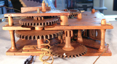

Norman BlissOops, sorry guys, didn't have this set for notifications, and I've replaced the weight cord. I thought this was nailed together, turned out the "nails" were easily removable pins, and I was able to get the arbor out. Now I have to do a full scale tear-down to clean the movement, and also will replace the strike-side cord which is also original, and never broke.
Here's a side view of the movement. I just removed the wood pins, and the two wire pins on the bridge, and was able to take the arbor out. Disassembly & replacement was easy then. This shows the original cord before it broke. Look carefully and you'll see one of three splices in this cord. Someone else didn't want to dismantle it either. Movement will run, but not for long, so I'll start trouble shooting with a cleaning. The metal bushings are filthy, but don't look too worn.

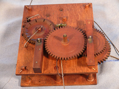

February 05, 2007, 22:16
Norman BlissFront view of the movment. No broken teeth or other apparent damage on this, so cleaning should be straight forward. Strike side works fine.

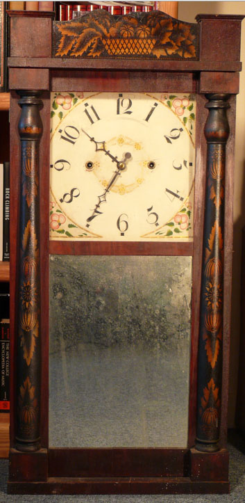

February 05, 2007, 22:18
Norman BlissAnd the clock itself--all original, except perhaps the weights. Glass looks original, and mirror definitely is. Weights are square, and the wear pattern on the label looks as if they were originally round.
