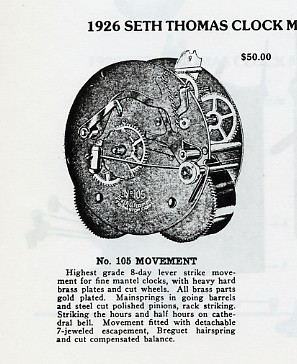

Tom SeymourBruce, Glad you solved the puzzle. When you said, in your initial post, that you had a "NO. 105" Was that a movement number or a case model number?
I see in the catalogue that the #105 movement is their highest grade (in 1926) 8 day lever strike movement. Movement is fitted with detachable 7-jeweled escapement, Breguet hairspring and cut compensated balance.
There is a picture of the No. 105 below. If that is not it, there are several other round lever movements in the catalogue.

Bruce ByrdHi Tom,
Thats the one. Nice little movement.. Not bad for 15 bucks..
