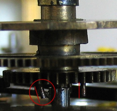

I recently acquired a 1920s Gustav Becker wall clock which works well except that it always strikes two on every hour. I took the dial off and noted that the rack doesn't get to fall down properly because it's stopped by a lever that is supposed to have been pushed out of the way by the time the hour arrives. The centre wheel, instead of having a four-lobed cam, has four small pins sticking out of it. The pin that arrives at the top on the hour is closer to the edge of the wheel and so it pushes further and releases the striking mechanism. The problem seems to be that this pin is bent and doesn't push far enough. I think the solution is to bend this pin back again. Here's the question: does anyone know if bending this pin risks snapping it off? I tried gently pushing it with a screwdriver but gently doesn't move it so I stopped. Thanks in advance for any help. One day I hope to have enough experience to help someone else :-)

John CroudyHi Tom,
Thanks for your reply. Yes, I live in Finland but I'm actually British. I don't know about the superior workman, I'm just terrified of ruining this lovely clock. I'm a bit of a klutz these days, always dropping tools into things and knocking things over. This is just a hobby at the moment and I don't have many fancy tools, but I do have a drill press and I think I could easily drill out the pin if it breaks off, but I think the replacement would be a piece of soldered wire
The idea of soldering a clock part makes me shudder but it would be the only way I could do it myself. The movement of this clock is amazing and I don't yet have enough experience to risk stripping it down. Besides, the bent pin is on that centre shaft that doesn't come off, so I'll have to do the bending in an awkward position. As for what bent it in the first place, my guess is someone forced the minute hand when the pin was pressed against the lever that it operates. I get the feeling someone has tinkered with this clock since there were several things wrong with it. The chimes were half a phrase out of sync, the chime bars were snagging on the movement, and so on. I have fixed those problems but I'll wait for the weekend before I'm awake enough to try your suggestions. I'll write again and let you know what happens...

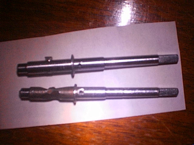

I had a typical American time and strike in for repair. One of the winding arbors was horribly mangled. As you know, the springs have holes in the ends, and the arbors have hooks. One of the hooks had broken off. Someone did a job on the arbor using his grinding wheel. He ground some of it down, leaving a nub of metal to catch the hole in the spring. To be fair, the person was probably the owner, and he did get his clock running again. Then again, someone may have done the job for a fee, which puts him in the "hack" category in my book. That was the kindest word I could think of.
The picture shows the mangled arbor below, and my replacement above. I put the poor old arbor in the case with a note that I had made a new one.

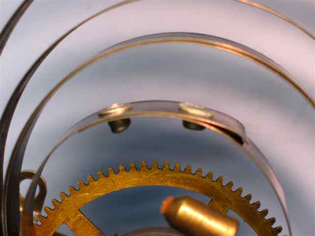

Bill CarlsonHi Guys, This is an interesting topic you have here. One thing about a Becker is that its built tough. They were made to last. One thing I would recommend is make your self some good drawings of the movement or take digital photos from every angle for reference purposes.
I have a couple of photos of a Mission Clock movement that was beyond repair, but it had some unique repairs made to it at some time on the springs. But the spring finally snapped in the middle.
I use a Webster spring winder, and have good luck with it. But I just got done with a Seth Thomas 120 movement and my spring winder didn't do much good on it. The barrels faced the wrong way. I had to wind the spring into the barrel by hand and that wasn't any fun. But its running beautifully now. The case isn't pretty tho.
Bill Carlson
May 30, 2008, 01:36

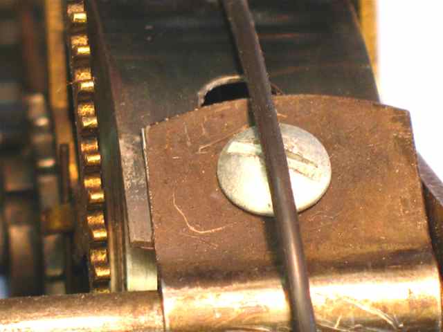

Bill CarlsonThis is the other spring repair. The picture isn't that good, but they had put a small bolt thru the spring. This clock had more badly worn pivots and bushings than I have seen in 30 years. I bought the same clock off of ebay and the movement was mint. It didn't look like it had hardly ever run. I was lucky!!!! And it was cheap !!
Bill Carlson

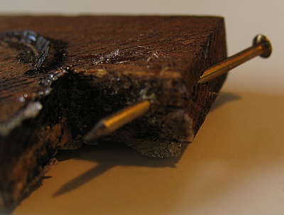

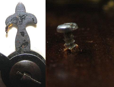

I'll attach another two pictures of horrors I found on my Vienna. There was a dead insect stuck to the hour hand and someone had put a screw into the case back which served no purpose whatsoever.

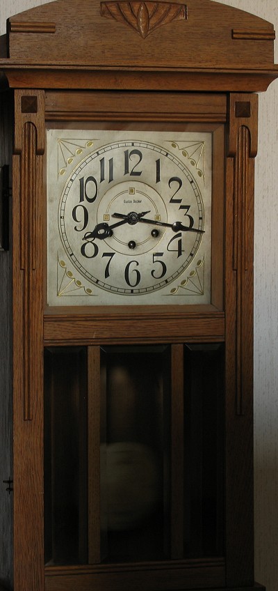

Nelson E. TimkenJohn:
Beautiful GB Westminster in Art Deco, what the Germans call "Jungenshtihl".
I have one, although not in as good a shape as yours.
In addition to the bent pin that advances the rack, I would check to make certain your hour hand is tight enough to advance the snail. If the snail does not advance, the movement will continue striking the same hour over and over. Gently check to make sure nothing is jammed, and move the levers near the snail gently to make sure they are making contact with the different indentations in the snail, which is what changes the rack settings and controls the strike.

Thanks for your input. I have verified that the snail advances correctly. In fact, I fixed the problem (for now) by putting a small piece of plastic tubing around one of the levers. This increases its width and gives an extra push to clear the rack. The clock is now on the wall and working properly, except it strikes about a minute late because of the bent pin. Would you be able to post a picture of your GB clock?
