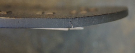

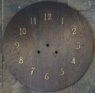

LAST WEEK THIS 110 YEAR OLD OAK FACE/DIAL WAS PERFECTLY FLAT & IN PERFECT CONDITION.
THE DIAL FACE WAS OFF WHILST I WAS SORTING OUT THE PENDULUM HANGER SPRING
I AM HAVING TROUBLE LOCATING MY MAINSPRING PUNCH THE FACE/DIAL ACCIDENTALLY GOT LEANED AGAINST SOME DAMP CLOTHES FOR A FEW DAYS AND WARPED.
THE FINISH ON THE FRONT DOES NOT SHOW ANY DAMAGE & IS STILL SMOOTH
HOW CAN I GET IT TO GO BACK TO BEING FLAT?
I HAVE IT LYING ON A SLIGHTLY HEATED FLOOR AT THE MOMENT
SHOULD I PUT A PIECE OF WOOD ON TOP AND ADD A LOT OF WEIGHT?

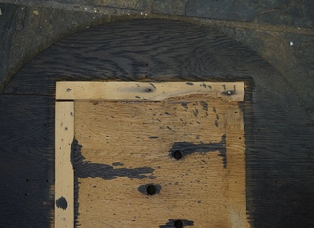

Thomas M. CusackSteam iron a couple blocks of wood and some clamps
steam from back. two pieces of wood top and bottom .Clamp to wood table. Work out slowly turn clamps slowly.When done leave clamped for a few days.
Dial looks to be maybe thee pieces glued together/
Easy fix go slow ,steam the part that's warped first

Roddy J. BruntonHi Thomas,
Thanks for the replies.
Just thought I'd let you know, the warm floor did the trick,  Looks almost perfect now and none of the front separated or cracked so far.
