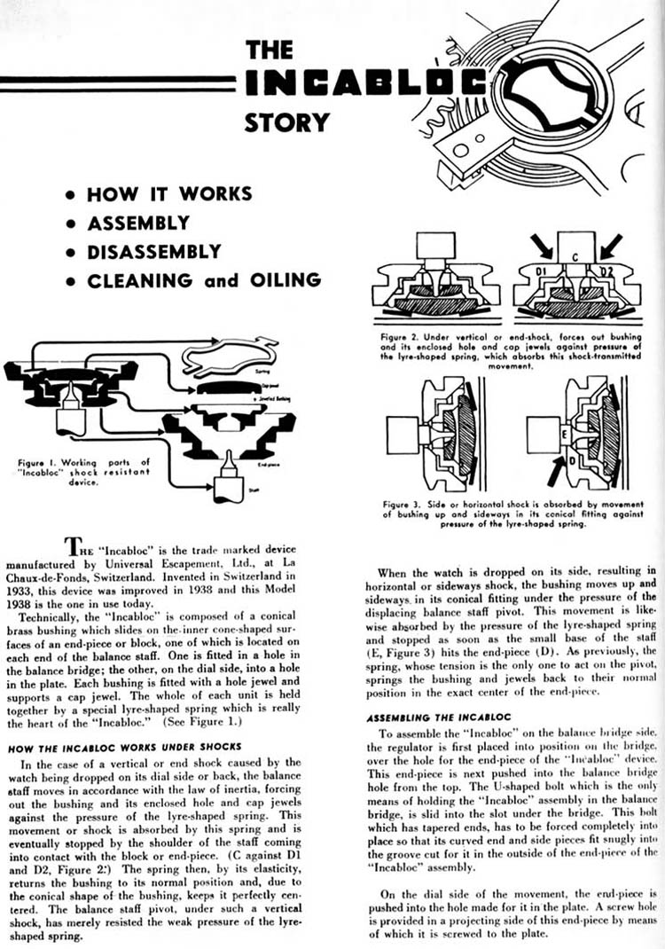

"The Incabloc Story"
I'm sorry that the following images are so large, but if I make them any smaller, even I can't read them!

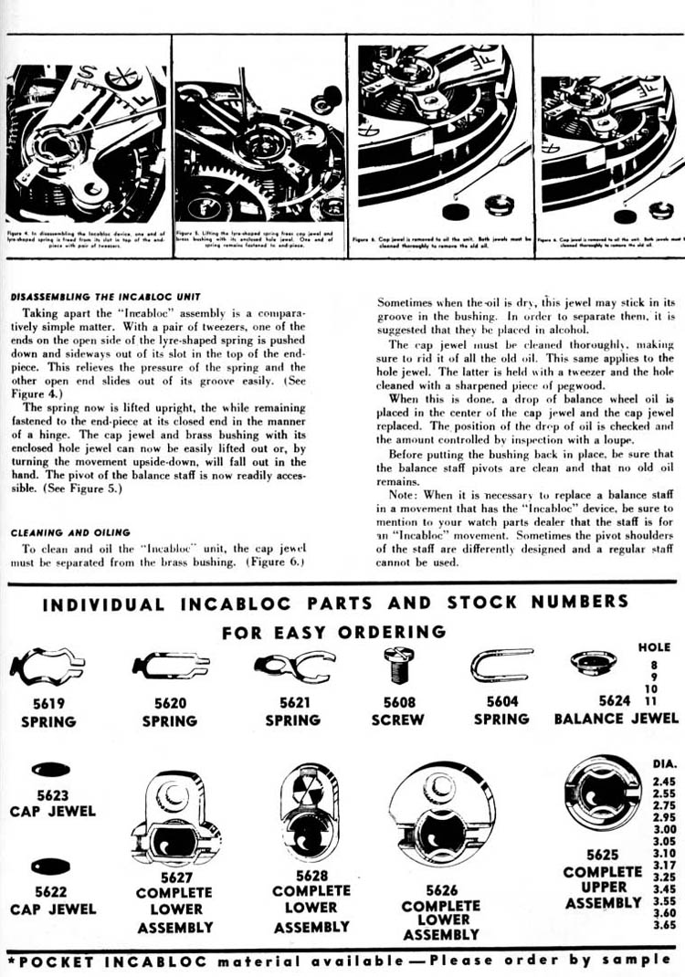

Part 2:

Ed Ueberall
Steve,
Thanks for posting the Incabloc info. Is there any date information on when this was published?

December 01, 2003, 13:58
Steve Maddox
Ed,
The information above appears on pages 210 and 211 of the old "Bestfit #101" catalogs. Those are the single-volume books which were published prior to the double-volume #111 sets. At least two editions exist, one copyrighted in 1952, and the other in 1956.
